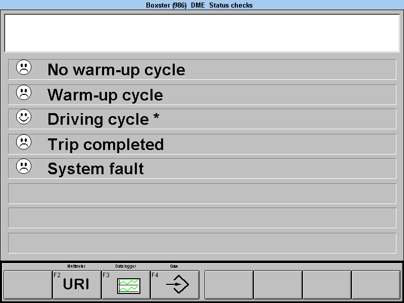

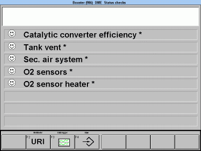

Get someone with a higher end OBD-2 scanner or Durametric to read what is not ready (there are roughly 9 items to be ready and most need 7 to be ready to pass a plug-in test). That will be far cheaper/easier than throwing unknown parts at it.
Ah, the durametric has less. I'm used to seeing this:
draft_lens7119312module58568782photo_1253570653Equus_3030_Innova_Diagnostic_Code_Reader.gif
If anything isn't set, it would not be a blackened circle. I think the Durametric would give you a far more verbose description of what is not ready on a boxster.

ok...got home and hooked up the obd tester.....still no codes, or pending codes. Checked emissions and these are the two items out of eight that show " inc" (inconclusive?) cat monitor & evap system. Also checked the report from the emissions place. Just says "Readiness = Fail" , KOEO = PASS, DLC = PASS , MIL CMD = PASS
...Checked emissions and these are the two items out of eight that show " inc" (inconclusive?) cat monitor & evap system.
And that's what you need to work to set by driving in the cycles that set those two. Once they are set, you can pass a test. Otherwise they will fail and set a CEL.
