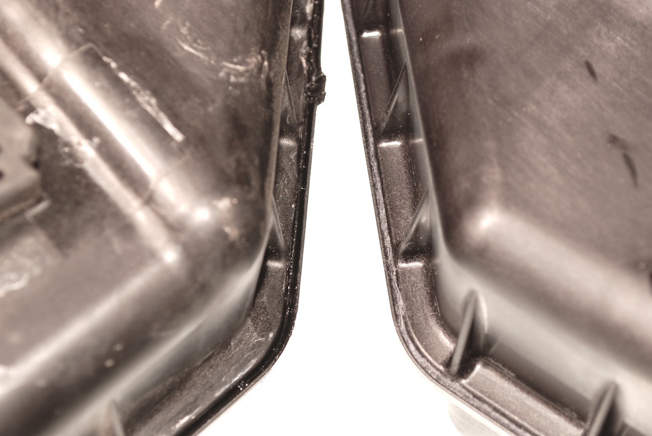

Well, not as bad as it could have been. ( '06 CTTS w/Coolant pipe update but not sure about the plastic T pipes) Driving last night I thougt I saw a little steam (cold night) coming from the front when stopped at a light. Bad things crossed my mind but forgot about it until this morning when I started her up and the low coolant light comes on in the Display. I checked it and it took about 3qts to bring the level up but no leak showing? I thought I'll drive it up to temp and see if the pressure forces it out of her, still bad possibilites in my mind. Well as it turned out the fluid started to drip down the right side engine compartment frame rail when hot. After removing the right side plastic engine compartment trim pieces I see it's leaking from underneath the Coolant Reservoir. I pull the Reservoir hoping it was a slight hose split but it turns out the Reservoir is leaking from the seam where the friction welded the two pieces together. Well, only about $54 from Sonnen plus shipping, so she is down for a few days until the new Reservoir comes. The part number suffix has been superseded from .22 to .23 from the one in my PET so I'm not sure if it is improved in anyway. What a relief though.
I actually have a car lift in my detached garage which makes it handy although initially I was able to crawl under the Cayenne with it raised to the high ride height position (Air Suspension). Greg at Sonnen got it shipped within 3 hours of calling him and had it to me in a couple of days.

Well thanks for the comment. I figured a way to get the Reservoir out and it indeed did leak from the seam at different locations. Received the parts and coolant within a day, and re-assembled the whole thing yesterday. The system is not leaking anymore, and the remaining task will be to find a place to get old coolant disposed before I can replace it.
Overall I split the job over 2 vacation days, where-off most of the time I did spend analyzing function of components and how things are assembled and of course removing more parts then needed. Looking into these things is always interesting and entertaining to me since I normally analyze very complex systems on the nano-scale while getting hands off the computer keyboard and some physical workout hanging under the car for free. However, as a car non-expert I always wish to find more information on rather trivial looking steps, and since I could find nothing specific about the reservoir replacement , I compiled a picture documentation of how I did the 2006 CTTS coolant reservoir replacement job. Hope this might be useful for others too.
