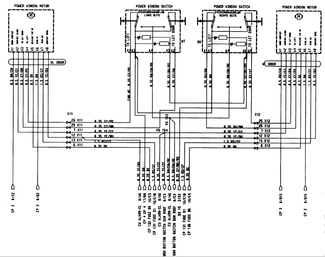

Does the passenger window work? Will it lower slightly upon opening the door? This is to diagnose the fuse.
If passenger window operates - at all - then while both doors are closed try lowering the convertible top, wait, then raise it, see if one or both windows move to the closed position.

Thought i'd record what i found for posterity.
The issue was the driver's side (UK) door handle micro switch. I stripped the door down enough to view the window motor spindle. I could see that it was only (intermittently) driving in one direction. Thus i guessed there was a logic issue. I started exercising the door handle microswitches then i noted that I was able to get the motor to drive in both directions. Re-assembled the door and the window is fine now. I guess that the circuit 'thought' that the window was already fully up and would not allow the motor to drive in that direction.
Hope this helps someone.
