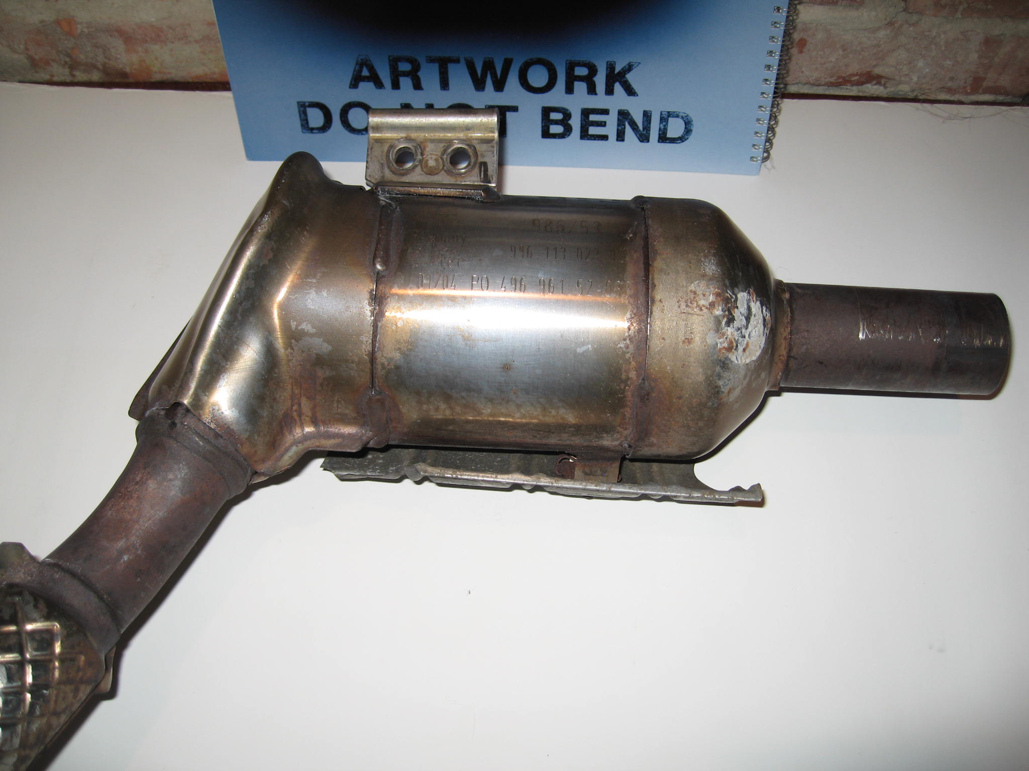

He listed the parts that need to be replaced which were:
*Converter, Exhaust Catalytic (Drivers Side).
*Sensor, Crankshaft Position
NOTE: No smoke tests were performed for Vacuum leaks. The Evap Canister was only mentioned in the writeup as one of the codes (P0446) that showed up and was listed as being: "Below Limit".
He also mentioned that the Drivers Side Cat seems to have been welded around the area that it has currently broken from, something that the previous owner must have done. (It lasted 7 years whatever he did).

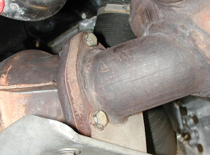

Setting the exhaust system noise problem aside for a moment, long before I would tell a customer that he (or she) needs a very expensive  cat replacement, I would have done a cat efficiency test on the side with the noise.  This is a very simple and quick diagnostic that can be run with most (if not all) Porsche specific diagnostic systems that would provide a clear picture of how the unit is working.  As for the welding he has observed, I would need to see the cat to be able to say if that is OEM of something done at a later time.  But would also note that all of the factory cats have obvious and often crude looking welds on them from the factory:

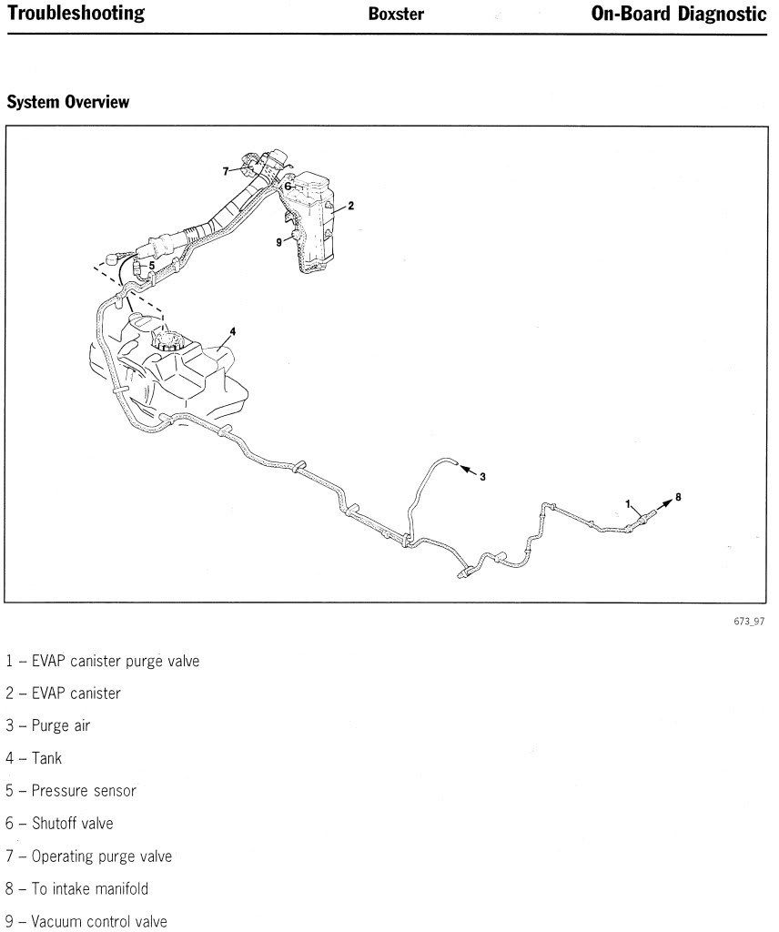

Moving back to the codes themselves, P0446 indicates a problem with the valve that is supposed to seal off the air purge line running from the EVAP canister to the intake system.  These valves are known to become problematic, often because of build up in the purge lines that eventually breaks loose and jams the valve itself.  While they often can be cleaned out, it is usually best to simply replace them while also blowing out the purge line itself, as they have to be removed to clean them and they are not that expensive.  The P1124 and 1126 codes indicate an overly lean condition on both cylinder banks.  Overly lean conditions are not a catalytic converter related fault, and as they exist on both banks, it cannot be caused by a bad cat on only one bank.  They are typically the result of an air leak in the intake system, which would lead you back to the failed airline purge valve.  And as I mentioned previously, many times exhaust rattling complaints on Boxster are the result of the multiple heat shields coming loose, which simply need to be reattached.

This is a diagram of the entire EVAP system on your car, which shows all of the components and where they are located.  The purge line can be cleared with compressed air:

OK, as for the lines to blow out, refer to my system diagram above, you want to blow out lines 1 & 3 after disconnecting both ends of the lines.

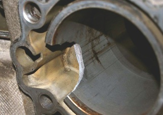

Your comment about the coolant system concerns me.  Early Boxsters with the 2.5L engine had cylinder liner issues that ranged from liner slippage to complete liner failure (commonly referred to as "D-chunking").  A completely tight cooling system can go literally years with no additional coolant required.  Something is not right; youe cooling system needs to be pressure tested, and you need to find out where the coolant is going.

D Chunking is the failure of the cylinder liners near their ends.  This is an extreme example of what can happen:
In its early stages, the chunk is still there, but the liner is cracked and allows the engine to pull coolant into the cylinder.
