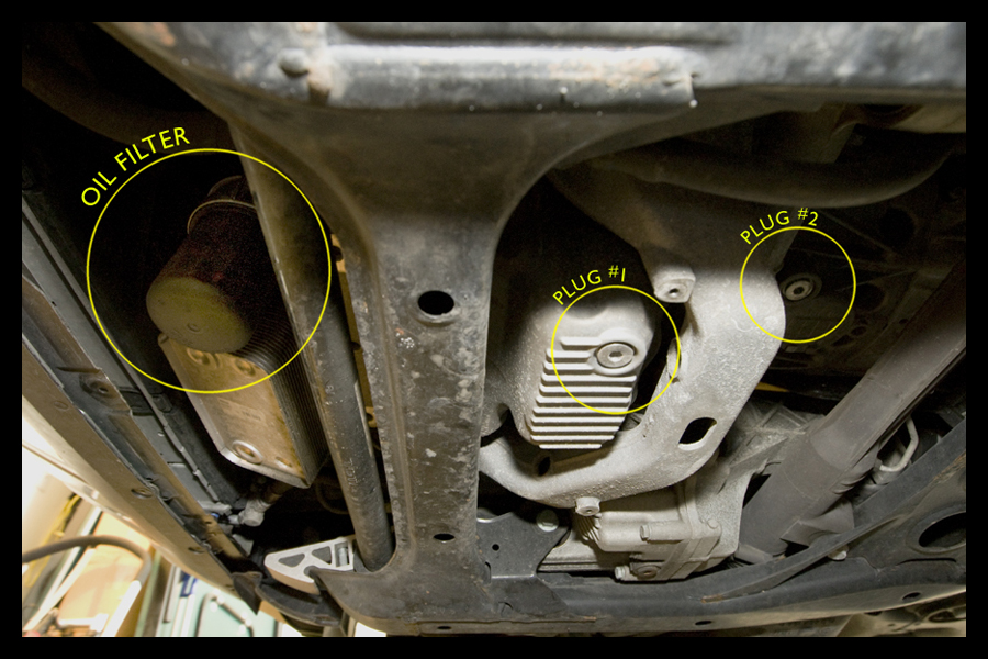

nobody posted pictures for these so called DIY's, I'll upload some pictures 2004 cayenne S, I just took off the bottom covers and my filter is in the front it doesn't have any screws or bolt on it. The casing is black plastic. All the previous posts referred to having to loosen up a screw to remove the filter. could it be that on the old models the oil filter casing doesn't have a screw?.. I'll post a picture in a minute I'm hoping for a quick reply to whether I can go ahead and remove the plastic casing just by hand instead (no bolts / screws are there to remove)
I have not completed the oil change yet I just took the underbody plastic covers below are pictures of the car. I want to confirm how to remove the oil filter and the correct drain plugs to use better safe than sorry.
Steps
1. Lift car or put on Ramps (in either case make sure to use STANDS as well!!! do not trust your jack or ramps alone), put foot brake on, and put stoppers on the rear wheels (pieces of a 2x4 would do)
2. Remove underbody plastic covers you will need (TORX 25 / 30 / Phillips screwdriver)
3. Remove filter casing / Remove oil filter / drain filter oil (as someone posted it's a good idea to put a plastic ziplock bag on the filter before removing it)
4. Put new filter back on / put O ring and lube with some oil / Tighten filter casing (Got filter from pelicanparts.com I think $13.00)
5. Remove drain plug #1
6. Remove drain plug #2
7. put back drain plugs #1, #2
8. Fill car with 0w-40 Mobil1 Synthetic Oil (Got mine from walmart at $6.25 / Qt, please post sources as this is the cheapest I was able to find)
9. Remove stops from rear wheels, remove foot brake, remove ramps / unjack the car
10. park car in a leveled surface and let sit for a minute. Check the oil level on the dipstick add oil if necessary.
11. Run the car for 3 minutes let sit for a minute, check the oil level again and check the car for leaks
12. Put car back on ramps and put underbody plastic covers
You're done :)

I don't recall anyone posting about a "screw on the oil filter housing" - not on V8 engines. There never has been one on the V8 engines (this thread is about the Cayenne Turbo (V8).
Only the V6 Cayenne has the screw on the oil filter housing.
Thanks for posting the photo on drain plug #2 which is very clear showing where it is. I have been wondering where it was last time I took off all the underbody panels, I had to put them back on since I couldn't locate the plug. And yes those plastic panels are a pain...
thanks for clarifying about the oil filter I was confused because some models had it and others didn't so I wanted to make sure I wasn't missing something. I probably should have created a new thread I posted in this one because it was the first one that came up when I did a seach for oil change. and I figured the V8 and Turbo were the same procedure.
