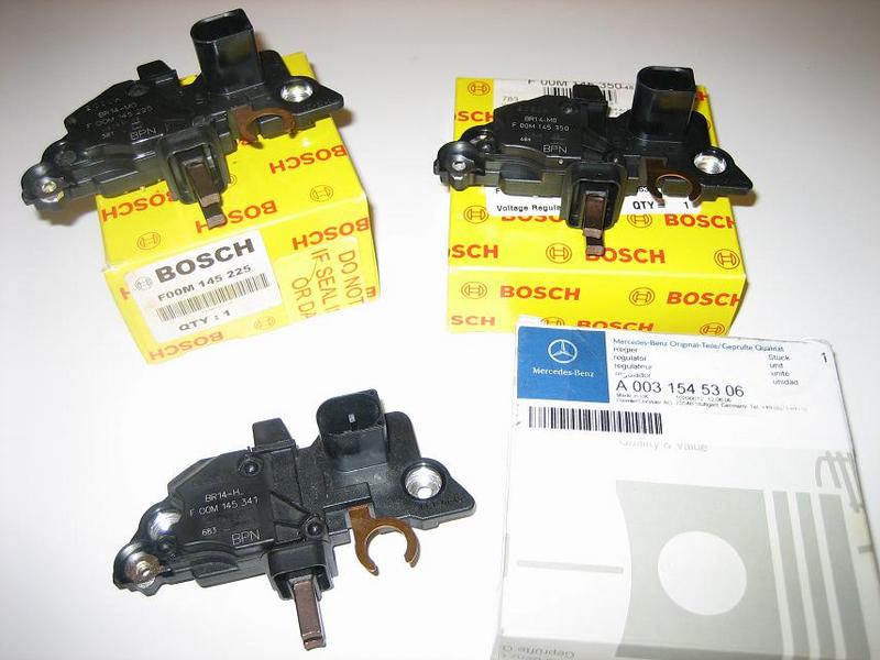

You can see the brushes on these regulators (All work on our alternators.)
