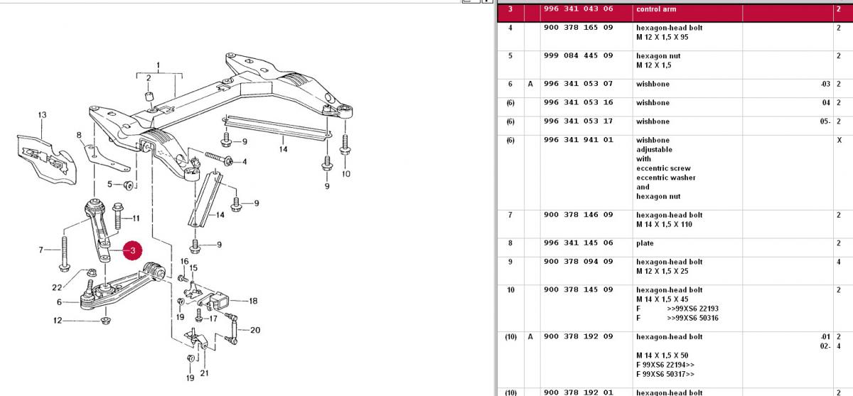

Went to replace the front control arms and sway bar bushings on my 2002 C2 Convertible. Got the ones from vertexauto with the replaceable ball joints. Started with the passenger side, easy breazy. Now here is where it goes bad, the control arms on a convertible are different than a coupe. You won't see the difference until you get to the drivers side, there is a sensor mounted on the control arm, the ones that I got from vertex did not have the boss to mount the sensor. What is annoying is that there is no prompt on their website for coupe or convertible. They should know better. Now it's pay the shipping back and wait while car is up on jackstands in the driveway. To me this is just poor service. They should have known better.

I can't see Porsche making two different sets of wishbones. I can see there being a difference when litronic lights were offered. Regardless, vertex should know better, the sucky part is while yes, they are a bit cheaper, it's a wash when your car sits on jacks for two weeks and you pay shipping twice

If the control arm has a hole in the middle part, you can definitely mount the xenon leveller on it. It just needs a small plastic bracket.
No hole where it needs to be, I had thought about going ghetto and zip tying it to the wishbone, but decided against it. This is definitely not a car one can easily work on, sure, once you know the tricks its ok. All about knowing the tricks.
I guess you could drill it, it's pretty soft aluminu.
Now I'm used to lousy service, it's the world in which we live. Vertex has somehow managed to transcend into the realm of how they stay in business is beyond me. I ordered lower wishbones with the screw in ball joint, the picture on their website is the correct one, the one with the boss/hole that allows for litronic headlights. Now keep in mind there is no way Porsche would make two different wishbones, so it's a model issue, likely V1 to V2. Ok fine, sent the other back and they put screw in ball joints in, fair enough.
