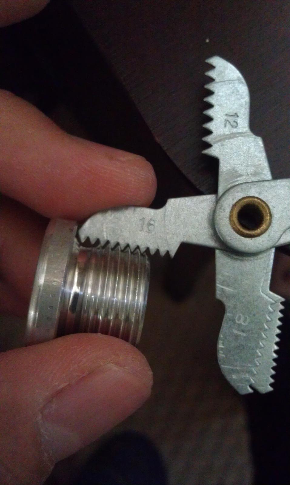

Anyone switched from OEM to using the LN magnetic oil drain plug? I have a 2002 4S and ordered one of these plugs but upon installing I found that after turning it in the pan 2-3 revolutions it got very difficult to turn further by hand ..... vs. the OEM unit that turns all the way by hand until it's completely screwed in -- in other words, pretty sure the LN plug was going to strip if I started using the torque wrench on it. I have an OEM oil pan..the standard that comes with the 996.
Sent it back to LN and they sent me a new one in case the first one they sent me was from a bad batch. The person in customer service (still trying to talk to the engineer) said they tried the plug I returned on a "universal" drain pan and said it worked just fine so they didn't have an explanation why it didn't work well with my 996. They sent me another one to try again but I won't get to try it until probably the Spring when I do another oil change.
Anyone encountered this? Given how many 996s are out there and the relative popularity of the LN products, I am a little bewildered if I'm the only one that's run into this.
Thanks in advance for any information anyone with a 996 has using this LN plug (working for them or not). Curious to know if it's just me.

That's interesting but as you said, still would not explain your problem. I would put the old plug and new plug side-by-side to inspect carefully. You can also try to mate the threads of the two and see if they match. Also, inspect the thread on the oil pan for any damage/debris.

I will try the new LN replacement drain plug during my next oil change, likely in the Spring. The plugs, when I compared them previously (the original is back in the car now), looked identical to my naked eye with respect to threading and I did not detect any damage/nicks to the threading on either. These were the first things I thought of. As far as the threading in the pan, the original plug goes on very nice and smooth, able to be turned by the fingers until it's screwed pretty much all the way in before the torque wrench is needed. It doesn't leak any oil at all that I'm aware of, etc.
Ferrugia, have you considered the possibility that the original plug could have been at some point crossed threated and upon realizing this the mechanic later corrected by removing and reinstalling, leaving the threads in a semi crossed-thread state?
I have seen this in several times after 15 years of experience working on various vehicle types. I have found threads that looked fine but did not offer smooth threading. As well, I have cross thread at initial install, realized and corrected which, made it nearly impossible to seat the fastener by hand after.
