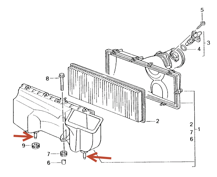

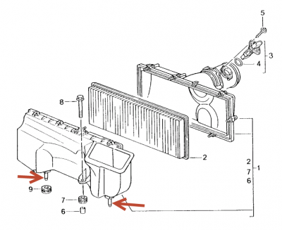

Back to your issue... Next time you pull the airbox, be super careful to find the grommets the pins go into. Most of the time for me they pop out and end up in the crux of the serpintine belt and a pully! If I were to reinstall with that still there, the next start up would shatter the belt. I had a P-tech for a local dealership warm of this and he was spot on.
As others have mentioned, getting it in takes about eight seconds once you get the hang of it. Hold the box as it will sit in the car, then rotate it about 100deg counter clockwise so the right end is point up and a little to the left. Then fit the round hose connection as you rotate it clockwise back to horizontal. Feel underneath that the pins are in the grommets and in the grommet holes. lock it down with that single elongaded bolt and tighten the hose clamp. Re-attach the MAF connection and you are set. if the attachment bolt won't align up easly, then it probably isn't in the grommets. Get a visual on those puppies before starting the car.
