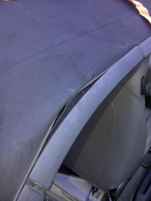

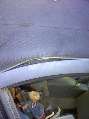

Mine was doing that when I first bought it. It was time for a new top anyways and I figured whomever I have put the new top on, could make some adjustments so that wouldn't happen anymore. Four shops later its finally fixed. It's really hard to find someone with the skill to properly adjust these tops. If your near LA I can give you a refferal.
My car has the exact same issue please let me know what you find out. I took mine to an upholstery / top guy and he didn't think it could be fixed. I played around with it a little to me it seemed liked the elastic that keeps tension on it was too short or out of adjustment. I am interested to see what you find.

Well it was a partial victory, I adjusted the cables in the back, under the clamshell and the top no longer rattles. However the kink midway is still there, my best guess is that the cable along the side is stretched, everything else looks ok. It appears to be "non adjustable". Any ideas? I know if I could find someone who was a bit old school, they could shorten the cable a bit. I hate to think that the only option is a new top. It still looks great.

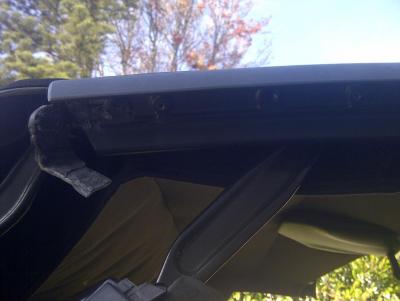

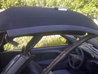

It is the cable, but I am having the hardest time figuring out how to get to it. I took off the weatherstrip, and the four Phillips head screws underneath, but it appears to me that piece is part of the frame structure, i.e. it's hinged. Please see pics. Any idea how to get this off so I can get at the cable attach point on the top of the "top"? post-41546-0-73250000-1358116725_thumb.jpost-41546-0-37764300-1358116840_thumb.j
I need to replace my cable on my 03 996 as well. I was fortunate enough to meet up with the guy that some of the local Porsche dealers use to do their top work. He looked at my top and confirmed I needed a cable and spent a few minutes explaining the process. He said it would be almost 5 hours of labor and talked about what is involved to install a new cable. I joked with him and said if he kept explaining everything that I might attempt the fix on my own. He laughed and encouraged me to do so and then took the time to explain in detail how to fix it. I think you might need to remove that philips screw in the left corner of the second picture. I also remember him saying something about removing the rubber seal that goes around to the front enough so that you can get to the front of the metal trim. I think once that black trim is off you have another set of screws to remove. He also mentioned something about a screw being covered by a piece of rubber. I am waiting on parts and I will be tackling this project myself very soon. Good luck I hope this helped a little bit.
