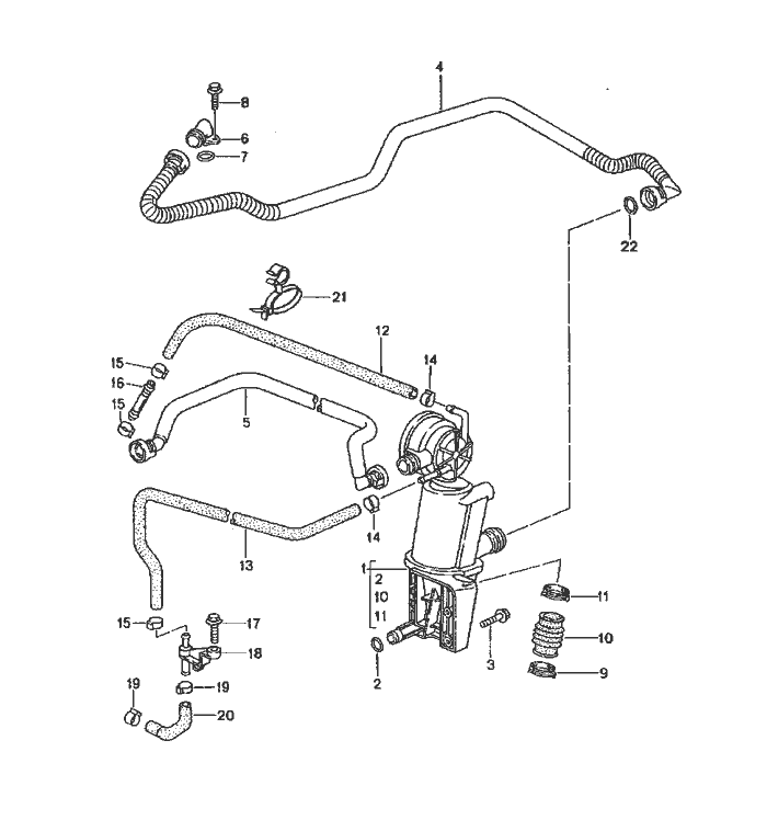

If I am correct, technically thats not the AOS. It is just referred to as an "oil separator" or "oil-vap. separator" and part of the emission system. AOS also refers to the parts in the engine sump. I hope these pics help.

I will know by tomorrow, but it seems that the leak is from this area and the diagram, I think, shows two coolant hoses at 12 &13. There also seems to be a coolant heat exchanger chamber on the top part of the AOS.

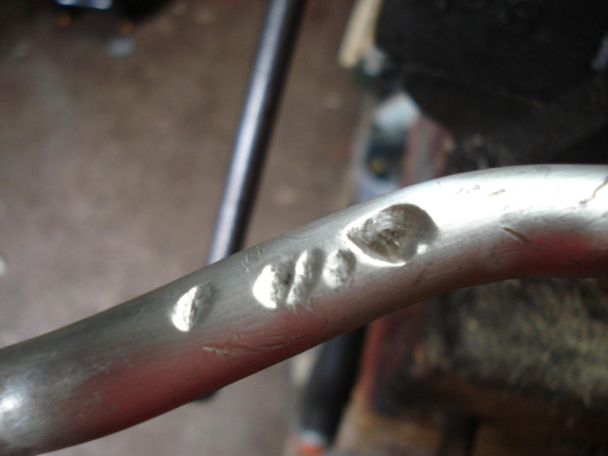

Well I have had a look with the car on the ramp and there is an worn part on a small diameter metal (about 15mm) pipe that rises towards the AOS. It has worn because it is in contact with a metal cable clip on its route up towards the AOS.
The pipe will have to be replaced and now I am wondering which part it is. I suspect it's 996 106 225 54 which is a left side vent, but I am not sure. Any info would be useful.

Just so you know, the MKII cars (2002+) do not have a bellows, the AOS was redesigned. The picture of the AOS in krazyKs post above is the MKI and the AOS does not look like that where it connects to the engine. It does not go in sideways as shown, but straight down. When you get your new AOS, compare it to the old one to be sure you have the right one, as they are not at all interchangeable. For some very odd reason, Porsche added a small rectangular "U" shaped plastic feature, maybe it is needed for another car, that is not on the original. It is obvious in a side by side comparison. If you do not cut off the legs of that "U", you will not be able to get the last intake manifold bolt in, as it completely blocks the opening to get a socket of any kind in there. Depending on the mileage on your car, if you are going to drain the coolant, it would also be a good time to proactively replace the water pump and put in a low temp thermostat. Does wonders for the car. my '02 only had 48k mile son it, and the original 11 year old water pump already had a slight amount of play in the bearing.

99610622554 is the bleed vent to radiator in the front of the car.

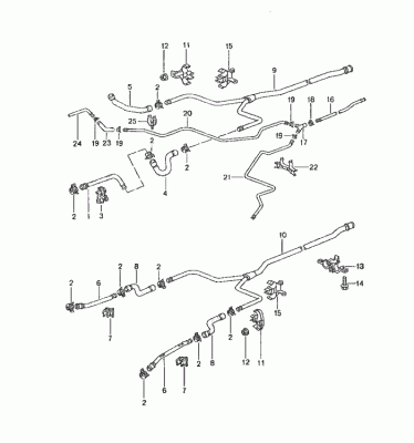

I think you mean the other end of the coolant bleed vent line #13 in the diagram below (99610668159), since that is the only small coolant hard pipe in the vicinity of your leak. One end goes to the top of the radiators and the other end goes to the top of the coolant reservoir.

I have got my money on pipe "13" as "4" is a large diameter metal pipe.
There are several variations of "13" and I think the later mod is a form of plastic so the dealership tells me.

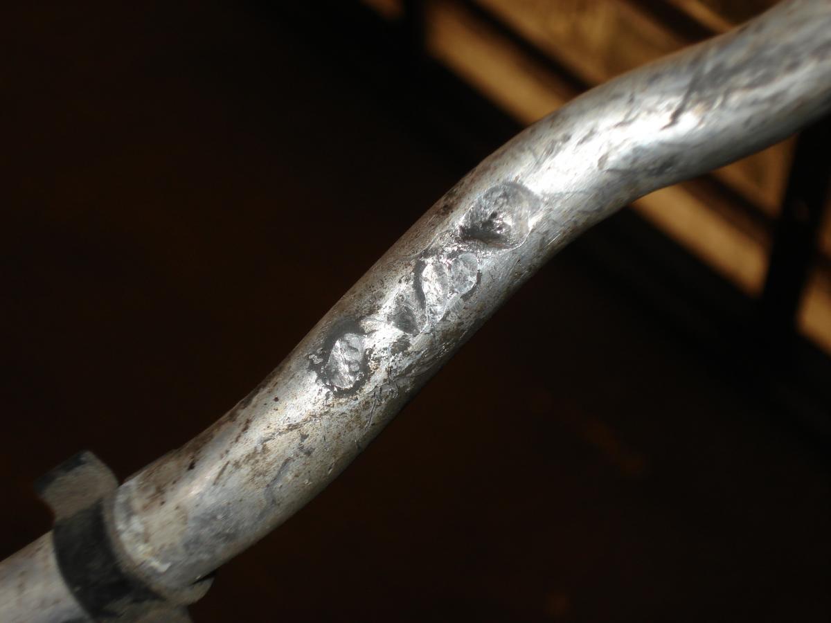

Well here it is and it's pipe No 13 in this diagram.
http://www.autoatlanta.com/porsche-parts/996-99-05/105-05.php
It's the aluminium vent pipe that returns to the header. I have attached a photograph of the hole where it has been rubbing against the clip near the block.

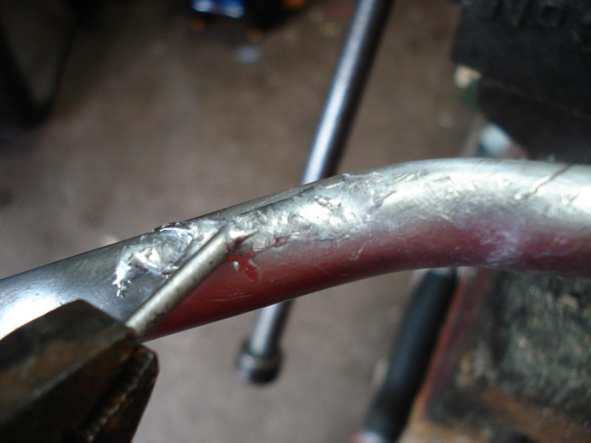

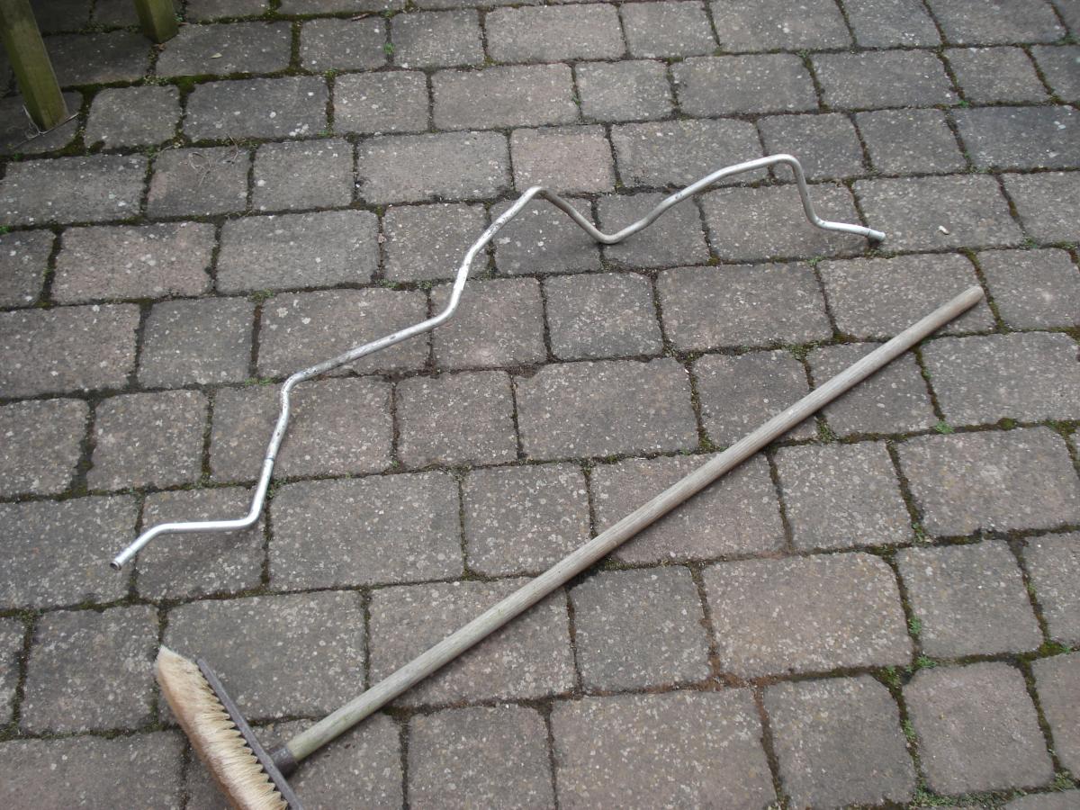

The pipe has now been replaced and it has been threaded through convoluted tube to avoid a second failure. I have attached a pic, with a broom as a reference.

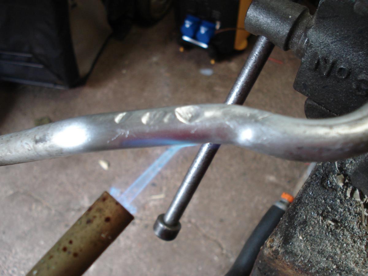

Despite replacing the item I had a go at a repair using Durafix.
www.durafix.com
It was both easy and successful and I did a pressure test afterwards to ensure that there was a seal. This is the first time I have used Durafix for a real repair job and it really is good.
