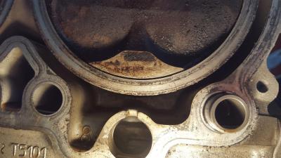

Hi Grujfo, I have a 2006 C2S that just experienced a cracked cylinder #1 wall.  I am contemplating doing the LN Engineering 4.0.  Aside from the resleeving, JE pistons (I think LN Engineering has a package that includes these pistons for $4600 US), is there anything else that needs modification?  I assumed with the extra power the updated motor is outputting, I would possibly need new cams, crank, intake, headers, or other stuff.

hello arthur li,
1.  sorry to hear about "the issue"  but, if the funds are available, i think you will be pleased with the result.
2.  necessary mods:  i did ask around about that (i shop where the car was at and i called up Charles at LN engineering)  the answer was  no.  sooo, for kicks i got the low temp thermostat, ipd plenum, and third radiator
3.  since the rebuild, everything has been running well.   i am now at 160K miles getting 24 MPG in the city!
4.  good luck
