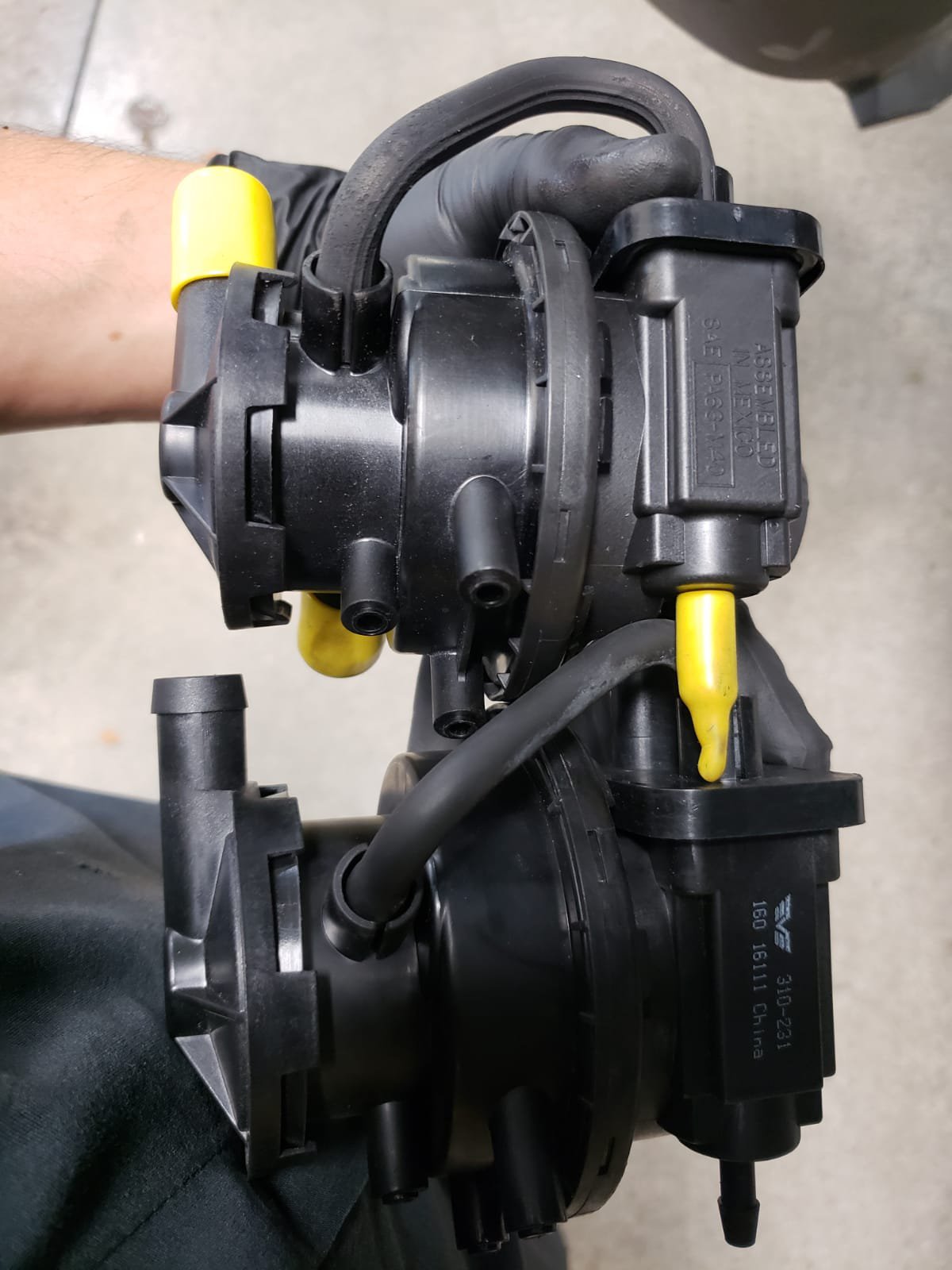

This picture shows the part that fails. In it, the electrical connection has been unplugged and the vent line has already been removed from the valve:
As the tutorial states, removal of the old part is more difficult than the installation of the replacement part and I as well chose to unplug all of the injector wiring plugs for access and actually cut the old line to ease removal. The only tricky part of the install is to make sure you route the replacement line beneath a small, hard plastic vacumn line located at the rear of the block. This picture shows the location:
After buttoning everything back up, I cleared the fault code and went for a couple of test drives. Problem solved, and kudos to Mudman2 for making these easy for those of us encountering this same issue.

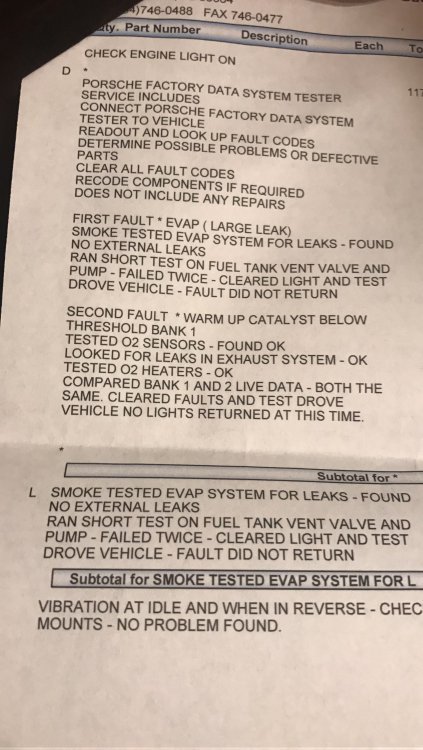

Bought a 2009 cayenne S (US spec) with 74k miles on the clock. It had the check engine light on with code P0455 (evaporative emission system leak - large leak detected). Picture attached
i took it to a shop to do a smoke test, they found no external leaks. They tested the tank vent valve and leak detection pump and it failed twice. (Pic attached)
