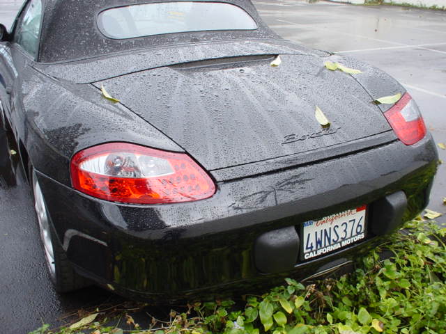

installed the GAHH top and ordered the cable assembly from Stevens Creek Porsche, I got mine installed at ABC upholstery, about $500 cheaper than at premier and I'm happy with the result so far (after 1 day..)

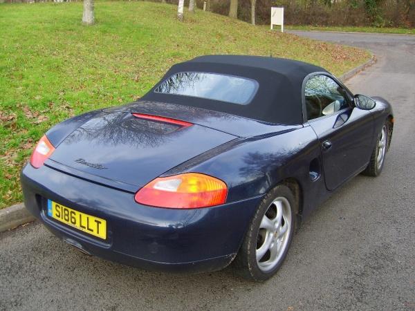

Also from the photos I have seen ( thanks to all who posted) the smaller window does not have as nice an appearance..as for as proportion...like a chopped gangsta look. I guess I'll have to see more photos.

3) I believe the answer is "yes" but you can look at the pictures posted in this thread and decide for yourself. Note that the factory top also has this.

actually I'm not that guy, I did it by phone, there's someone else who
I was at the parts counter today and spoke to the guy who took your order. You are the second person he knows of to order the hardtop electrical connector, as you said.

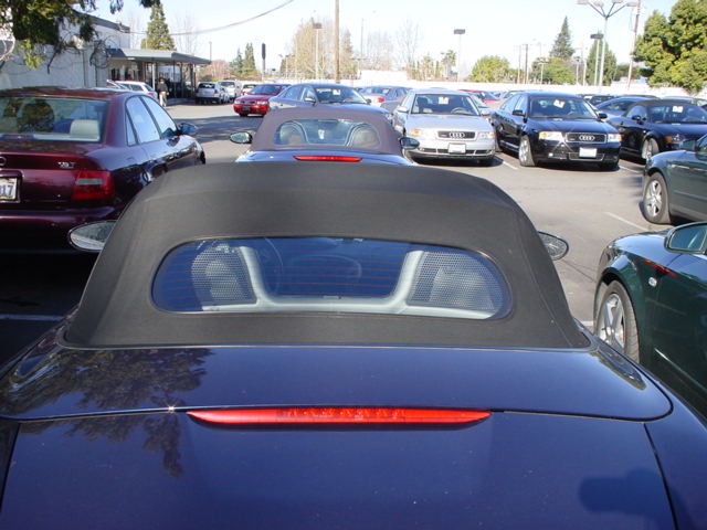

I saw these pictures at the counter.

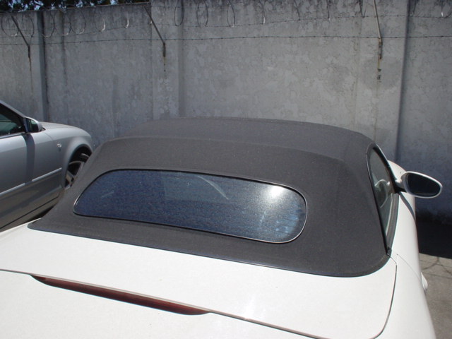

I recently bought the GAHH top, and since I live in the area, and they offered me a hefty discount if I let them take pics of my car, I let them install it. When it was done, and I started raising and lowering the top, I noticed that there was an incredible amount of stress being put on the part of the top where it's connected to the bottom of the rear glass window. No sooner did I notice this, than I further noticed that the window was becoming separated from the top at that spot.
GAHH told me they came to the conclusion that the tool they were using to seal the window to the top was defective, and they were having it machined. They are going to try to fix this for me, but I wanted to suggest to those of you who have purchased the GAHH top to keep a close eye on that area where the bottom of with window is sealed to the top. When I saw how much stress is being applied to the top when it's opened (due to the glass window,) I got the sinking feeling that it is inevitible that it's going to separate at some point.

Well, I finally saw the top in person in the back lot at my local dealer.

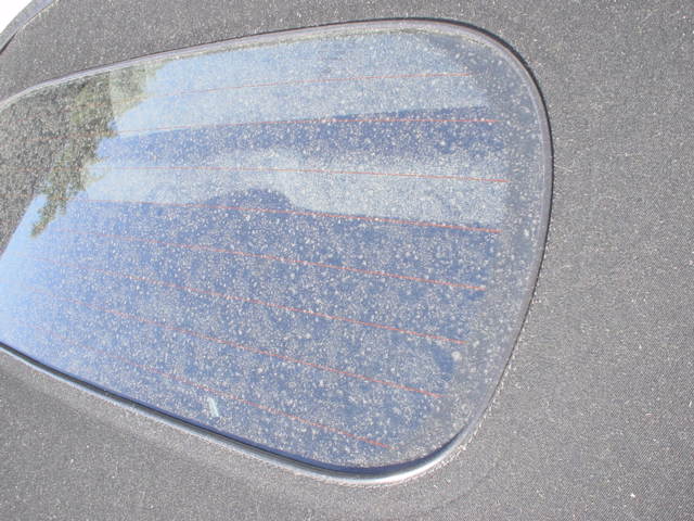

It is a 2000 base with tip. I measured the glass at 34 1/2" wide by 10 1/2" high. I wanted to get a good picture of the defroster lines but the car was dirty and I was not about to wash it. The material looked the same as OEM.
Bad news on the GAHH top. The first one they put on for me had to be replaced because the glass separated from the canvas at the bottom. They re-tooled, and put a new top on. I got that one back, and the very next day, I noticed that the glass had become completely separated at the top. (I had not even raised or lowered it yet!) It was as if it were never sealed at all. This is especially distressing to GAHH because they have been sending these tops out all over the country. Anyone thinking about ordering one of these tops should probably hold off until they find out what's going wrong. I'll keep you posted.

Mine is doing the exact same thing, but is is on the top of the window instead of the bottom. It looks like the black glue they used was not strong enough to take the stress. I have left a message with them and am awaiting a call back. I must say that it looks pretty bad from the inside and the outside. I am hoping they have aq solution as I am located in rural Ohio, far from their shop. I will keep everyone updated.

The link from Paul has 2 new pictures of the BAS International top with a new style glass window that does not have the large orange defogger lines.

Thanks, I though I saw orange lines on the top in the picture from Premier just like BAS. Trivial, or you can stick to the plastic window. Put your top in the service position and take a picture.
