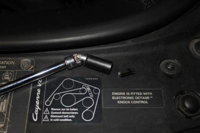

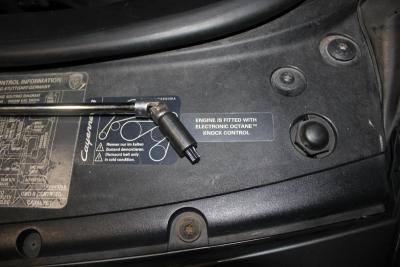

It's a pain. I'm doing this right now. On the turbo (and I'd imagine on the S) I've pulled the air injection pumps and brackets and also removing the airbox cover, such as replacing the filter, have helped and quite frankly I'm stunned that isn't in the Porsche service manual. My symptoms were smoke from burning oil coming up from the passenger side. I've had to run the heater on recirc to keep from sniffing fumes from the burnt oil. Anyway, the gasket I removed broke and is very stiff. I have to give credit to the person who designed it. The rubber getting old and brittle is about the only way for this gasket to fail. Oh and I had to cut down a t-40 bit to fit a bit driver (1/4") with a universal joint and extension to reach and be able to loosen/tighten the lower back corner bolt off of the cover. The service manual warns about this. I'll post pics of that "tool" when I finish up.

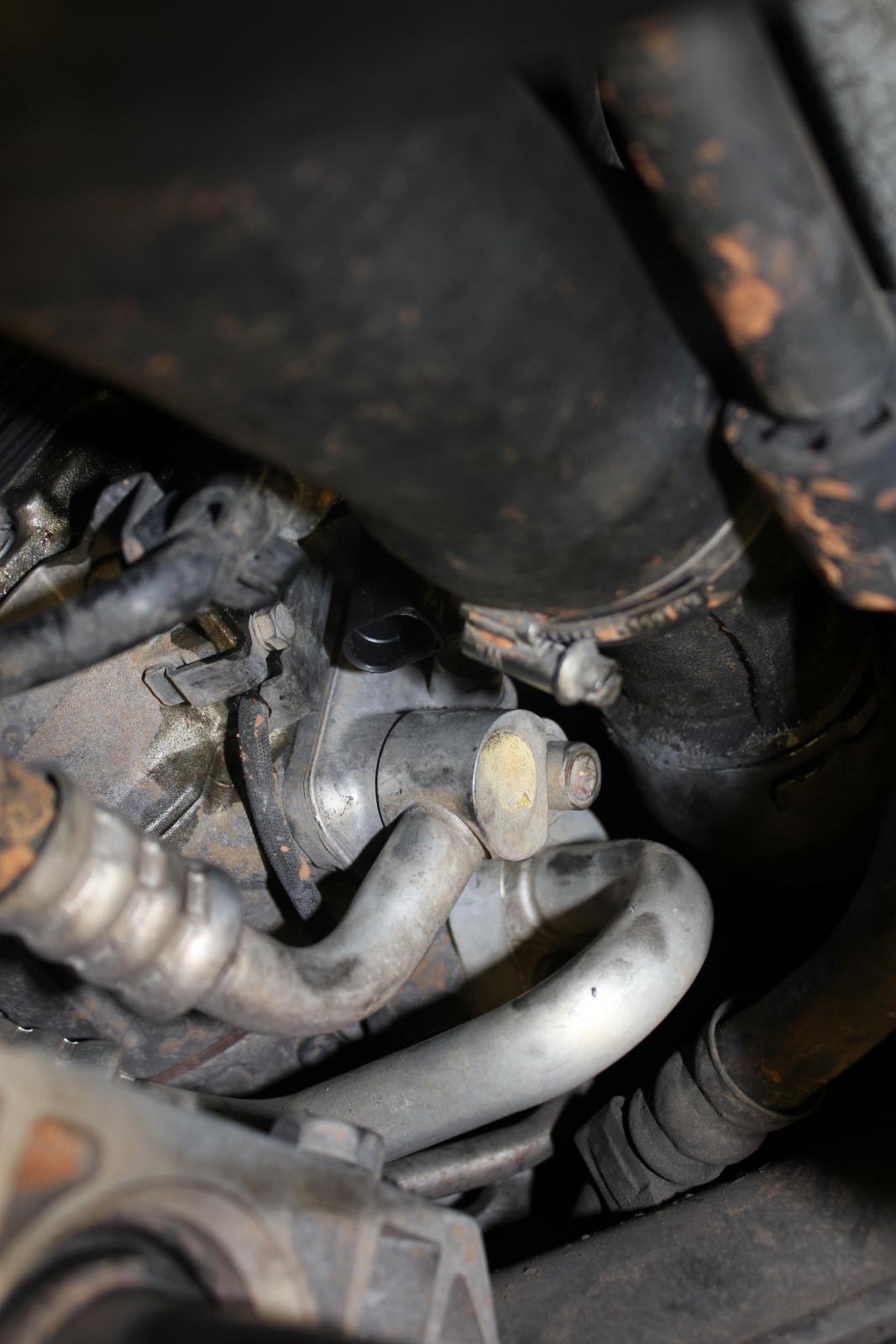

Pics as promised to get the rear, lower corner bolts off the covers. I also had to use it on the left (driver's) second-to-the-rearmost bolt as well. In the process of doing the valve covers I broke both sides of the crankcase vent tube(s). You can cut off the hard pieces with a razor and use 3/4" heater hose to re-plumb it. The fitings are already barbed to accept the hose. Some hints along the way: if it looks like something will be in the way, it will be so just remove it so you don't fight it later. Remove the lower engine cover just like you would if replacing the oil filter. That way if (when) you drop something you can get to it quickly. It's also necessary to remove the AC harness plug on the left side. I couldn't get it off without unplugging it. The trick with it is the tabs that hold it together are facing into the freon fitting. You need to slide the connector off the mounting boss (grooved) to get to the tab. Once you get it off, rotate it 180 degrees as shown in the pic so the tab will be on the "visible" side and be easier to get to. I did have to route the wiring differently putting it all back together but with a couple of zip ties it fit just fine.

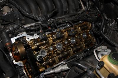

Of interest after taking the covers off, it appears that Porsche put the silicone RTV on the valve cover side of the gasket where the front cover and head meet. In the manual you put the RTV on that seam to make sure it seals and there was nothing there when I pulled them off. Weird. I did this over two separate weekend days. It takes a lot of time just to remove and bolt things back on.post-35813-0-01506000-1390309168_thumb.jpost-35813-0-61563400-1390309191_thumb.jpost-35813-0-84994300-1390309208_thumb.jpost-35813-0-19162700-1390309231_thumb.j
Of interest after taking the covers off, it appears that Porsche put the silicone RTV on the valve cover side of the gasket where the front cover and head meet. In the manual you put the RTV on that seam to make sure it seals and there was nothing there when I pulled them off. Weird. I did this over two separate weekend days. It takes a lot of time just to remove and bolt things back on.tool1.jpgACplug.jpgtool2.jpgVCoff.jpg

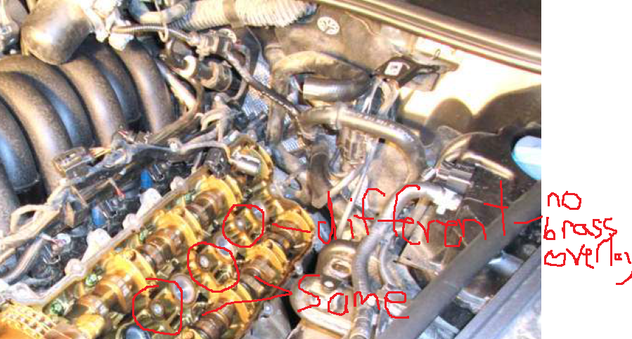

Hi Guys,
Im in the middle of doing the valve cover gaskets.  I started with the passenger side.  When I took the cover off, there were these brass looking bolts with holes in the middle.  cyl. 1-3 had them cyl. 4 was odd duck and did not have it.  I looked on pelican and the picture of the valvetrain looked the same with the odd duck brass fitting.  It doesnt look right.  cyl 4 had a misfire.  Im just wondering if any of you might have an hd picture of the passenger side, or even know what im talking about.  The picture above shows the drivers side and all the brass fittings are missing.  It looks like those, but only one.  the rest have brass fittings.
  Please help.  I have to have my car.
Edited by coolbronco
I saw the hd picture above but it was drivers side and missing brass
