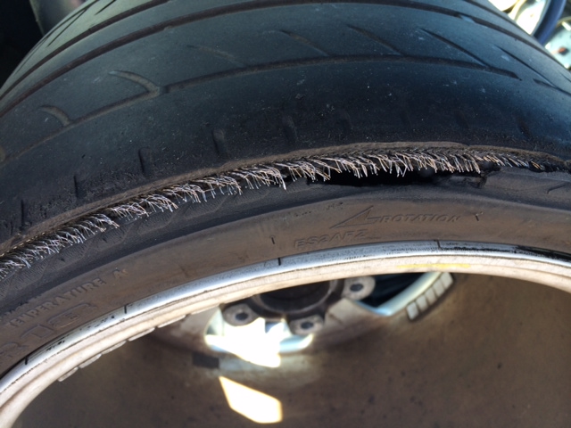

I agree with fpb111 regarding date codes especially on Porsche. I also think a lot of us take for granted what speeds we really drive. I dont know if you have ever had a high speed blowout? I can tell you from experience its no fun! It can even kill you. If you cant find a matching set of Michelin Pilot Sport A/S I would not mix tread patterns or MFGs. Thats my 2 cents worth, see the tire below that shot me across the freeway and almost flipped my car @ 90MPH. One of the most important parts on the car we all try and skimp out on. Just buy a new set of tires your car will also drive better.
