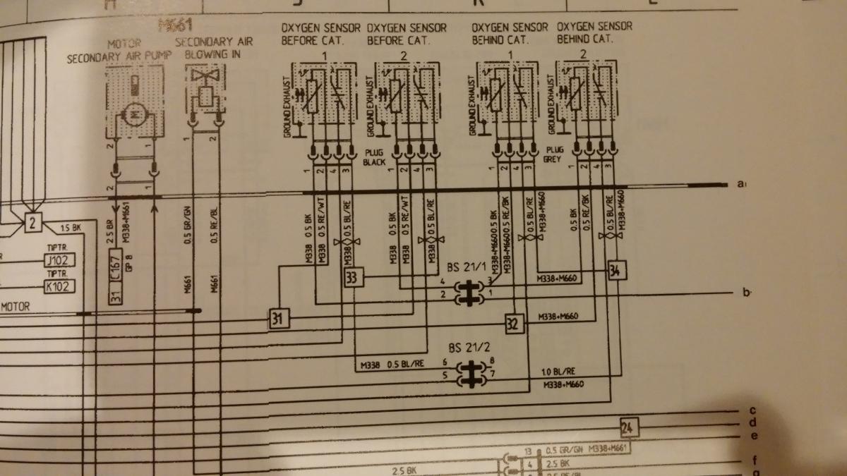

Ok, this is getting more interesting.
I assume you meant "0.5v" and not "0.05v" for the O2 signal. If that's true, you are correct that the problem (at least) is at the power supply to the heaters. All the wires you measured are the correct wires. Gray dust on sensor is normal.
1. Check fuse C2 (30A). The power flow is: 12v power->C2->injection/ignition relay ->line "b"->BS21/1->black wire of the O2 sensor heaters black (see the diagram below). In case you blew the fuse while you were measuring. The relay and the fuse are not shown.
post-5282-0-52283100-1395978748_thumb.jp
2. Turn the key to the last position before cranking like you did when testing
3. Measure the red/white heater wire (connect the black meter probe to a ground point such as the rear lid latch) and you should see ~2v. This is the ground supplied by the DME but it's never 0.00v. If it is, you have a wire break between the heater and the DME.
4. Measure the black heater wire (connect the black meter probe to a ground point) and you should see ~12v. If not, the only connection point between it and the injection/ignition relay is the BS21/1 bridge point located at the rear relay behind the rear seats below the carpet. check the voltage there.
In position 6 here. Here I'm assuming your injection relay is good (position 2) since this relay also supplies power to the ignition coils and your car starts find. Depending on what you find, we may need to revisit the relay.
post-5282-0-09305000-1395978986_thumb.jp
5. Repeat steps 2 to 4 for the postcat sensors (yes postcat) and you should get similar readings. That will help us diagnose it further.
6. Measure the resistance of the heaters. They should be ~10Ohm
Let me know what you find and good luck.

Ok, looks like you get the 12v power to the heaters on all the 4 sensors but their grounds being at 0.00v are questionable.
Combined with your previous measrement that you also see 0.0v between the RD/WT and BK heater wires, I suspect the heater ground wires are FLOATING and disconnected from the DME.
Check this first: measure BK again to make sure you get ~12v on BK, then immediately measure between the RD/WT and BK again and see if you get ~12v. If not, the RD/WT wire is floaing.
There are no connectors in the back seat for the O2 sensors. Their ground wires connect directly to the DME. Refer to the diagram above, the precat heater ground wires of both sensors are joined at junction "31", which then connects directly to pin 30 of the DME (not shown in the diagram). Similarly the postcat heater ground wires are joined at junction "32", which connects directly to pin 1 of the DME.
The next steps will be more involved...Can you:
1) Disconnect the battery -ve terminal
2) Disconnect the DME from its socket
3) Check for continuity between pin 30 (RD/WT) of the DME socket and the RD/WT heater wire of the precat sensors?
4) Check for continuity between pin 1 (RD/BK) of the DME socket and the RD/BK heater wire of the postcat sensors?
DME 5.2.2 pinout info here.
Since you pulled on the wire harness, I guess it's possible some wires got disconnected at the DME socket end although hard to imagine since the wires are all taped in a bundle...
Good luck.

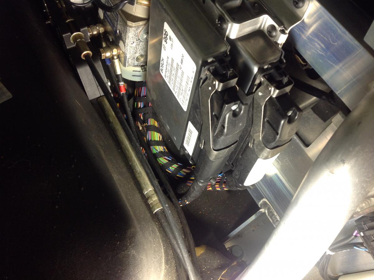

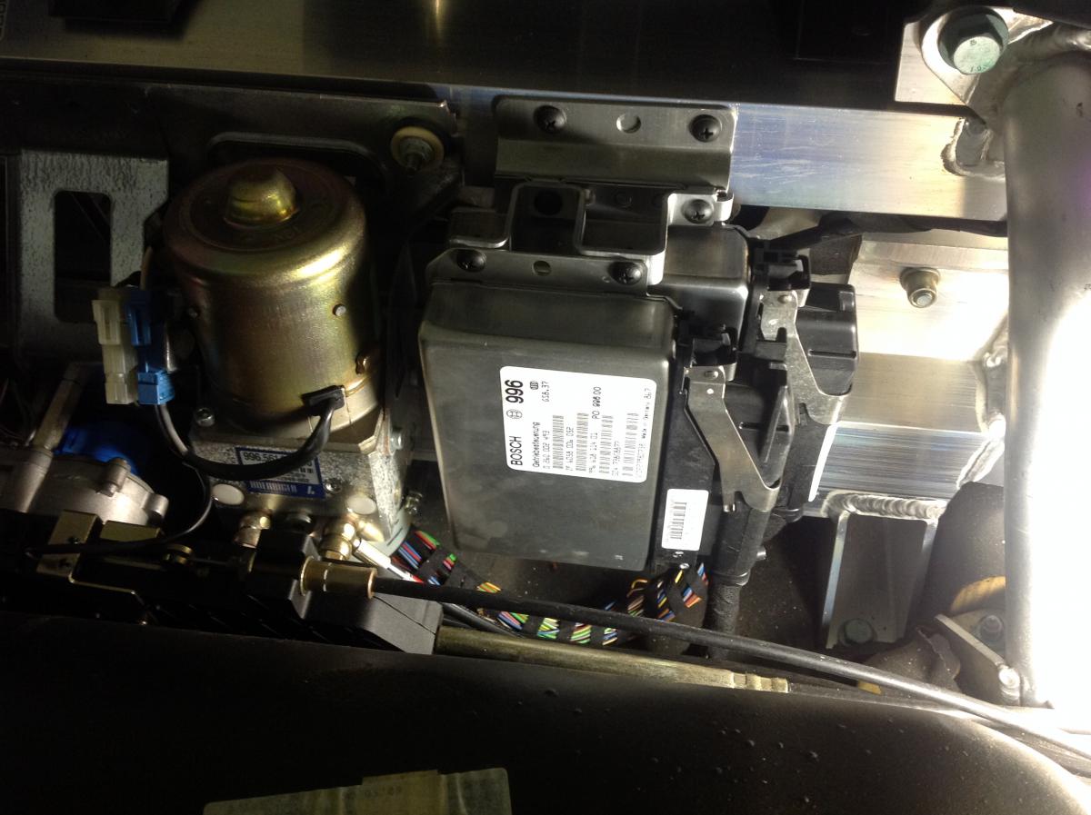

Looks like there are two silver boxes .....question is which is the DME?? Both have 88 pin connectors.
OK got it................ the was the box on right. A little slow but at least I'm steady.
Got continuity between pin 30 (RD/WT) at the DME plug and socket (RD/WT) heater wire of pre-Cat. sensor.
Got continuity between pin 1 (RD/WT) at the DME plug and socket (RD/BK) heater wire of the pre-Cat. sensor.
What now? Your thoughts?

Ok, I think the next step is to install two new precat sensors and see if that cures those O2 sensor codes. The 0v measurement between the heater wires may be fooling us as the ground is provided by a transistor in the DME and perhaps it won't supply ground when the sensors are not installed. On mine (DME 7), I got around 10v between the heater wires.
Now at least we know for sure the sensors got positive power to the heater and also signal from the DME. Also the wires are intact. Only DME and sensors are left and I would bet on bad sensors.

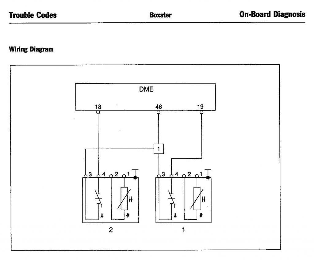

My thought process keeps taking me back to this being a wiring problem ahead of the sensor rather than the sensors themselves. Below is the Porsche diagnostics process for both P0130 and 0150 (it is from the Boxster OBD II manual, but should be exactly the same on this car). If the problems persist, I suggest starting over from the beginning as we are obviously missing something:
P0130and0150sensordiagnostics_zps905d1e3P0130and0150wiringdiagram_zpsb27b2369.jp
What's puzzling is he performed all the tests under "Check Oxygen sensor" and varified that ~0.5v between pins 3 and 4 on ALL 4 O2 sensors so the DME signal is getting to the sensors. However, I agree that 0.0v reading from Durametric also means signaling wire shorted to ground since the DME outputs 0.45v on that signal wire (pin 18, 19) with respect to the ground pin 46. Basically inconsistent measuements that cannot be reconciled.
Perhaps he has an intermittent problem where the fault comes and goes at different times when measurements were taken.

Guys, not to sound pedantic, or like a broken record, but as long as there is no voltage to the two O2 sensor, fussing with other items is not going to get the car running any better. The O2 sensors have to get power and be functional for the car to have any chance of running correctly; their operation is critical to controlling the fuel trims.
John, the OP did confirm there's voltage (0.5v) to the precat sensors (harness side) multiple times hence the challenge.
I understand that, but as the Durametric system is looking at them from the DME's perspective there still is no voltage being read, so they are effectively dead to the DME. Without the reference signal differential between the pre and post cat sensors, the system literally does not know what to do next. I would start tracing the harness from the sensors towards the DME, looking for damage, pinched wires, etc. The DME has to see voltage at both sensors to control the mixture. I'd also like to see the Durametric reproduce the pre and post cat voltage curves:
ThreewaycatandO2sensoragingdiagnostics_z
If the system is not generating the two different voltage curves, the fuel mixture is basically out of the DME's control.
