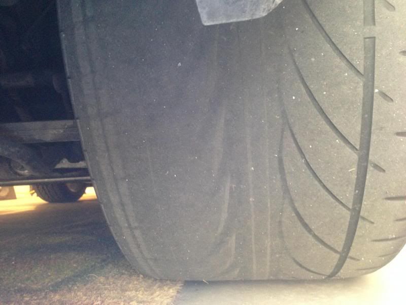

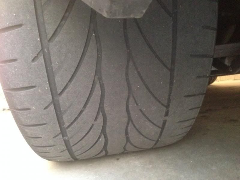

Here is what the tire wear looks like comparing one side to the other. I have tires ordered should be here Monday. I also have an alignment scheduled.
Passenger Rear
Driver side rear
Edited by SLC911
You power out of left turns a lot? :)
Thats one thing I thought about, but hard to say for sure. The last set wore the exact same. I have drove this set harder than the previous set. So we will see what the alignment comes back as. I hope they find something or I am going to have to drive like Nascar but with all right turns :D

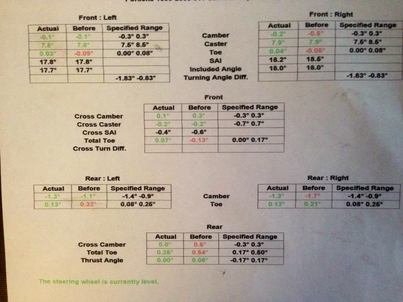

Here is the alignment sheet they gave me. Hopefully someone call explain the above tire problem and what this shows me. Are the adjustments they made going to help or do I need to take it to a dealership for a better alignment? :unsure:
