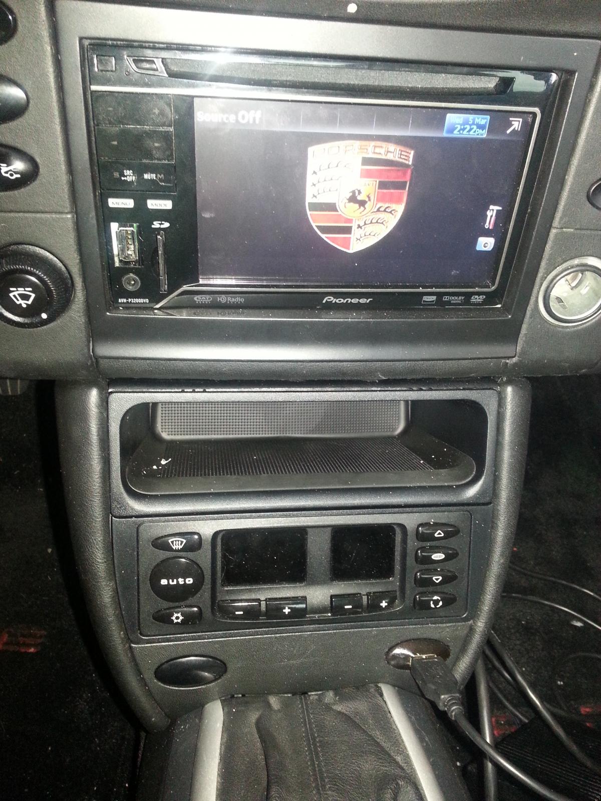

This is the one I used for mine, no GPS though. I have a Pioneer AVH-P3200DVD.

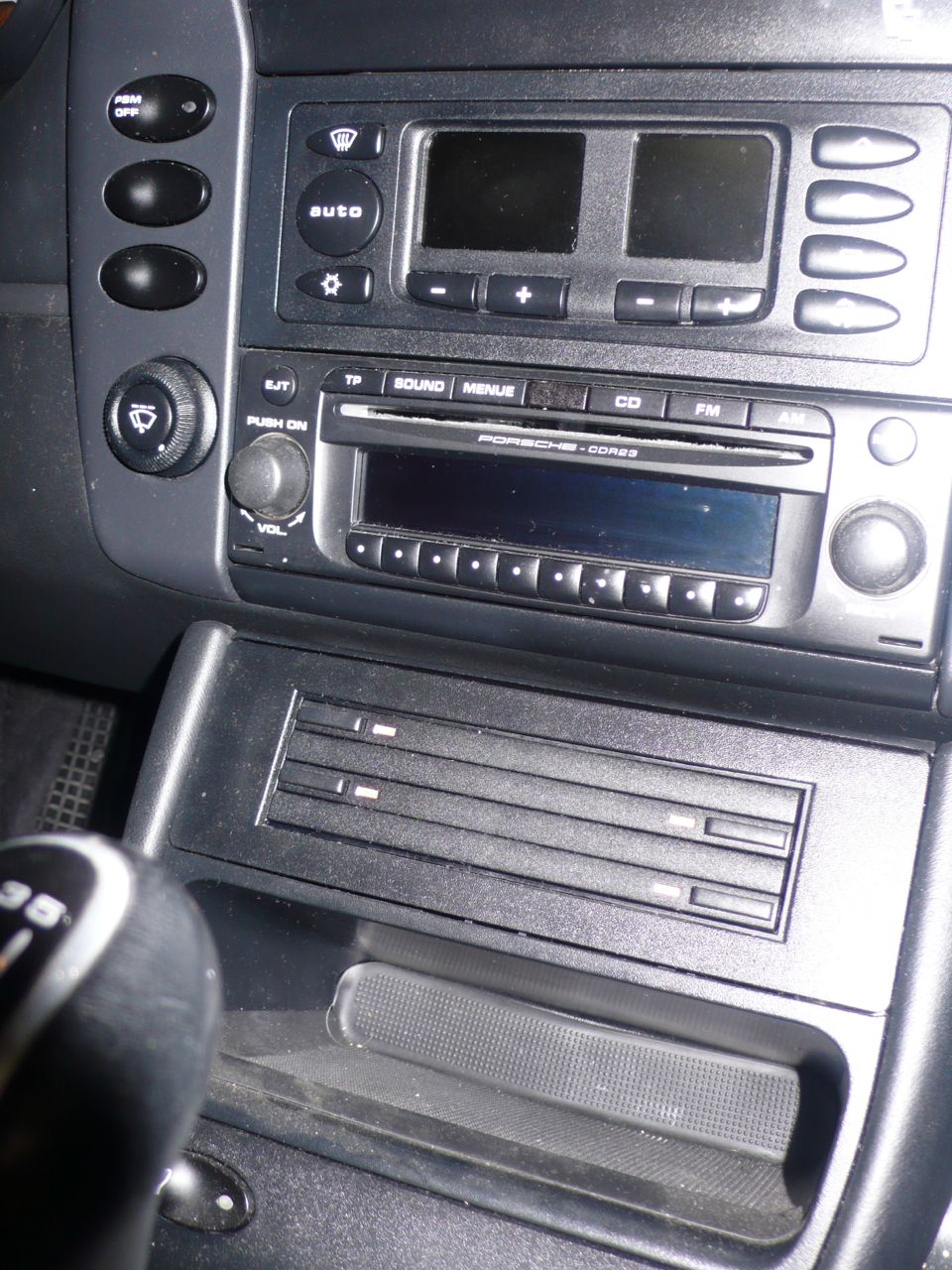

Thanks for the leads and heads up... What I don't understand is what you do with the heater/A-C control panel if you're installing the double din monitor?
Does the A/C panel move to the CD storage opening? If it does then will you have to lengthen the wiring to make that happen?

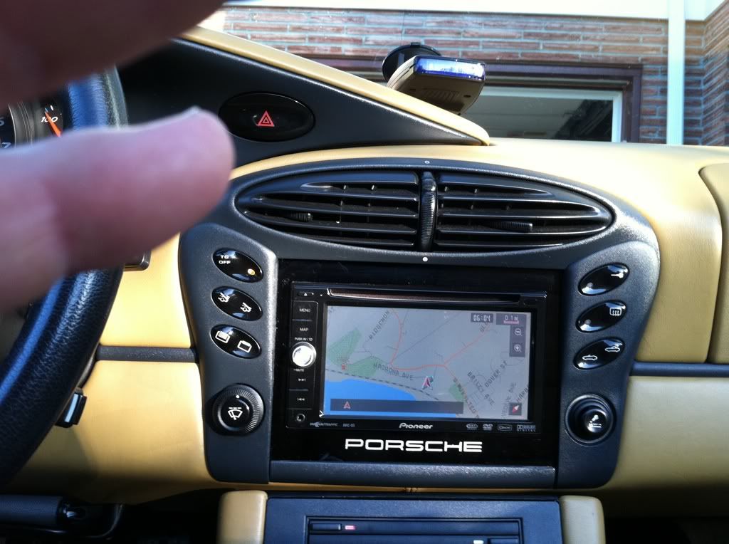

Hi8ha, nice installation... who's monitor is that? Did you ever consider installing the A/C panel in the C/D storage bin? I read on one of the
replies that it complicates the install. I'm not sure if you can get a face plate, or you'll have to make one. Did you install a backup camera?
I'm considering that, I have one in my D/D and it's pretty handy. Plus in my old age my neck doesn't swivel around like it use too.

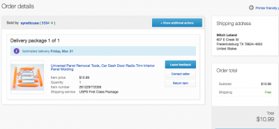

Here's the product I bought per your information, and thanks again...
