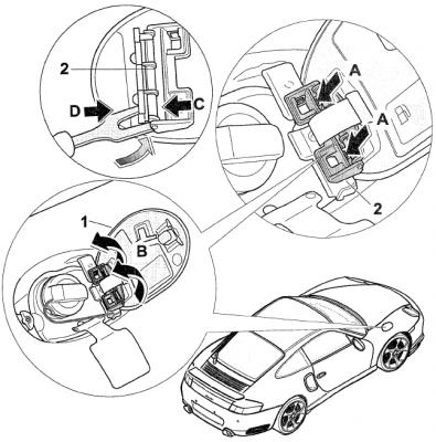

Door - Insert a narrow screwdriver from above in front of the clip arrow A, press the fastening lug in direction of arrow B and hold, and carefully pull off the filler flap 1 upwards.
Hinge - Insert the removal tool at the locking lugs on the left and right and lift via the locking lugs, remove the plastic hinge 2 in direction of arrow from the filler flap 1.

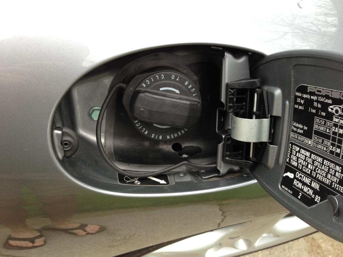

Ah, I need some quick help! I new I needed a new hinge so I ordered one, and thought the 996 number was superseded by a 997 number. The 997 hinge does not fit though! It hits where the tether attaches. Has anyone had this problem? Currently I have no means of attaching my fuel door, since I have a broken 996 hinge, and a non fitting 997 hinge :( Thanks in advance.
I moved the tether from the hole on the lower right to where it is now, not sure why that hole is there. However, then the spring hits it. So, I moved it back to the original hole, but put it in backwards. Seems to work well enough.

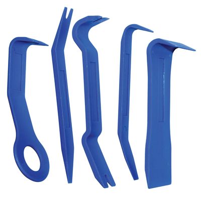

Sorry Im late to this but I never use metal tools for work like this. Keep a set of these handy. There are many jobs they can be used for while working on your Porsche and they wont easily scratch it like a screw driver. Their perfect for CI and they wont scratch peoples cars. $15 at Auto Zone.

I never did post what I finally ended up doing.  Here's what it looks like now:
Thank you!  I just needed to see where exactly the spring clip went back.  Had no problem with removal of anything, but forgot exactly where the clip attached.  Jenny

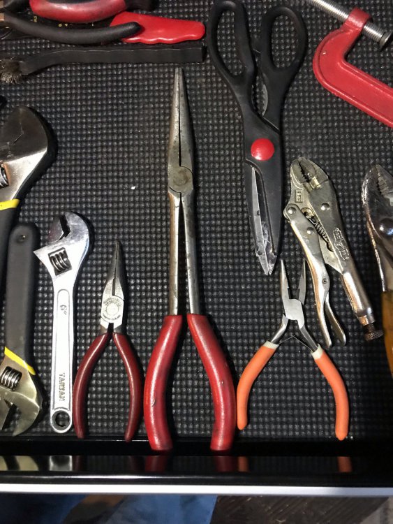

I spent about 30 minutes trying to removing my fuel door. After I finally got down to your post about removing it with a long pliers, I was then able to remove it in 30 seconds flat.
Here is the pliers that I used. Your description was spot on. The only thing I did different, I removed the fuel cap and put my finger behind the plastic to use as leverage in popping it up. I was concerned about breaking the plastic. Thanks a lot!
