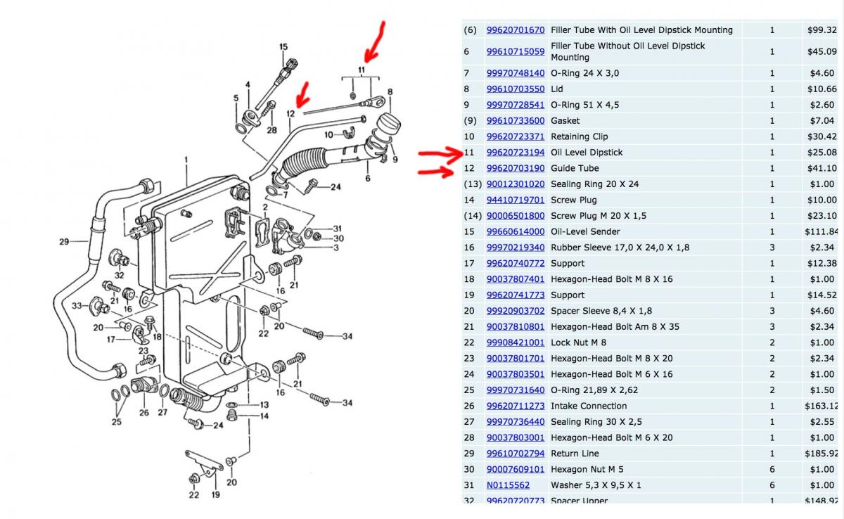

Dealers charge 20 hours total for removal and installation. But it can be done in less than 16 hours. I would like to know exactly what sensor, related to your problem, need the engine removed….There are one other option for you, the installation of a GT3 dipstick….
This is really useful! Do you know if I can literally just buy the indicated parts and have them fitted? Are they difficult to fit? Many tanks.

Thanks for that. I think this would be the best option for me. However, that thread only suggests fitting the GT3 dipstick. It's unclear whether or not it can actually be done without dropping the engine. Anyone know if it can be done?
