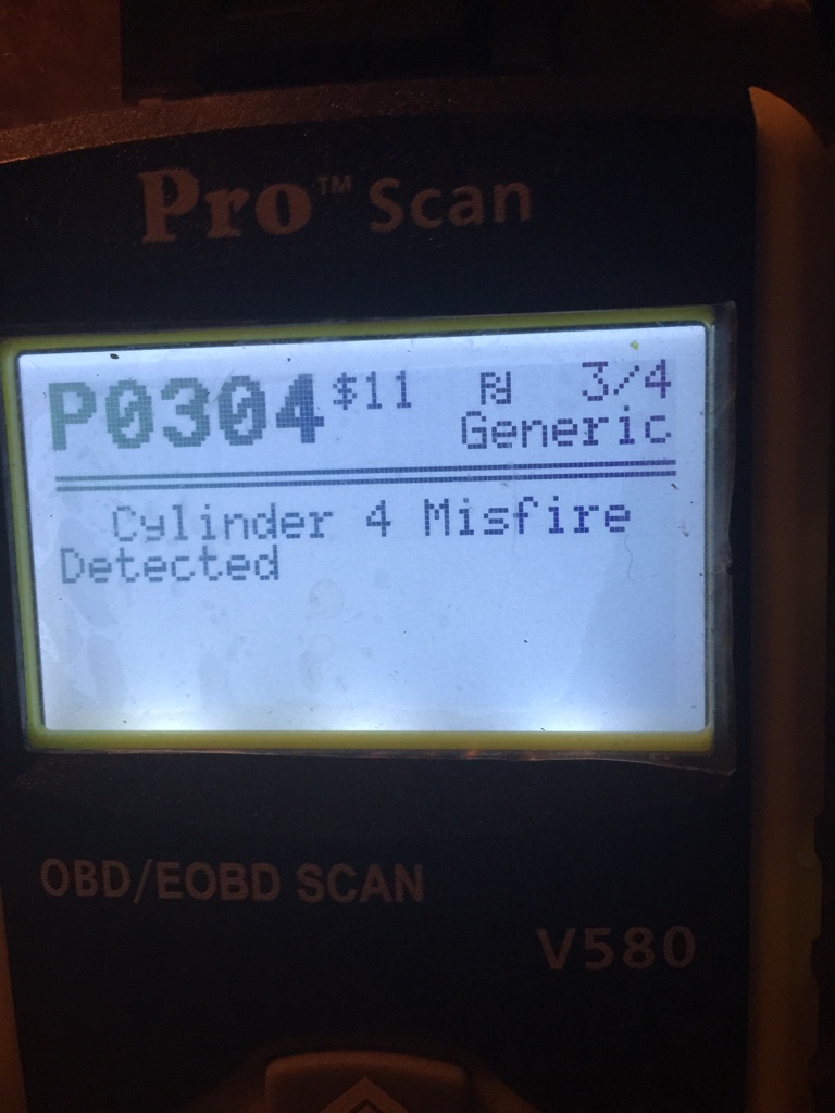

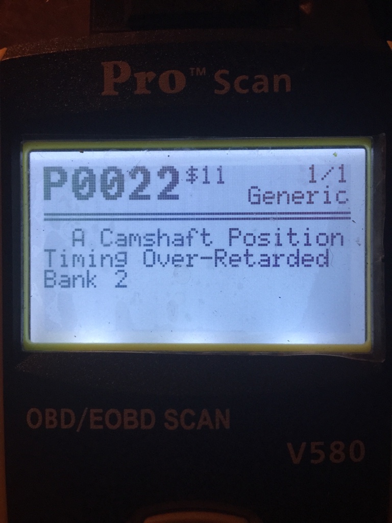

The codes that come up was
P0022- a camshaft position over retarded-bank 2
P0300-random/multiple cylinder misfire detected
P0304- cylinder 4 misfire detected
P0305- cylinder 5 misfire detected
P0306- cylinder 6 misfire detected

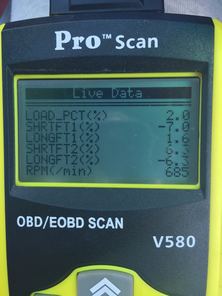

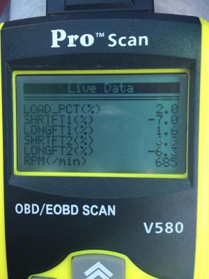

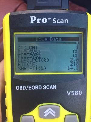

I also plugged my scanner in while the car was running and took some pictures of the fuel timing but not quite sure how to read them,if there good or bad.
Hop you guys can help these are the fuelling timing pictures.

The first thing I would do is get the car scanned on a Porsche specific system; quite often, generic or "global" OBD II scan tools come up with misleading or completely erroneous codes.  You are also going to need a Porsche scan tool (PST II, PIWIS, Durametric) to read and clear the air bag fault as well; there are very few (and very expensive) aftermarket scan tools that can do that.
You appear to have multiple misfire codes, which while annoying, are not life threatening to the car.  These can be anything from old sparkplugs to bad coil packs, which will need to be isolated and corrected most likely by replacing the failing component's.
Get the car rescanned, noting all the codes, and then clear them.  Drive the car and see what comes back, if anything.  You would then have a valid basis to move forward on getting the car fixed.

No direct experience but found this thread mentioning P0022 troubleshooting for 996 Turbo. I think it may also apply to your model.  The diagnostic steps call for testing the variocam+ timing hydraulic solenoid using a special tool, which most likely simulates the DME and supplies PWM pulses to activate the solenoid. So if those codes are real, the simplest case could be just a faulty bank 2 timing solenoid, which also explains the bank 2 misfires.

I'm hoping its this simple,my friend who Remaps cars says it looks like a vacuum leak by looking at my fuel timing.. Hope it's just a simple solution,I might just get the garage to change the part from 1 bank to the other bank to eliminate the problem,iv seen the parts are only around £100 each so I'd get them both changed on bank 2 if that is the problem :) thanks for the advise so far guys I'll update tomorrow as soon as they have finished.
