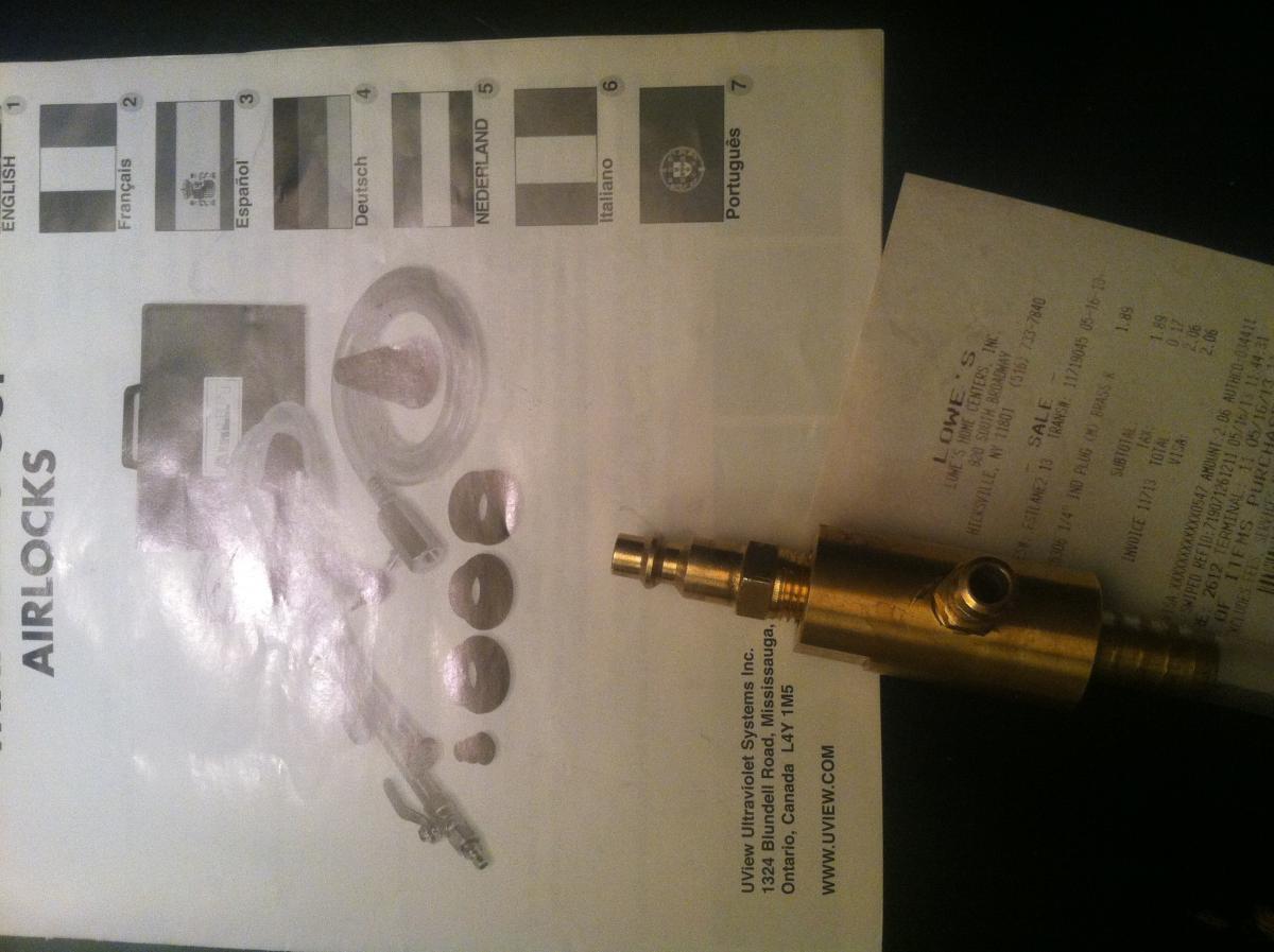

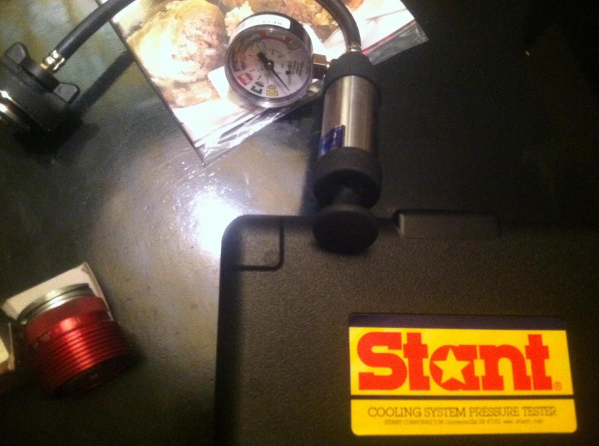

To be honest I only used the one in the trunk just once, for a punctured tire (if I remember correctly the manual states that it should be used for that purpose exclusively); for my coolant jobs, both pipes and reservoir I just borrowed a pancake style one, i think they sell at lowes for less than a hundred when on sale. The uview lift and the pressure tester I got on amazon. If you use the uview system you'll need to buy an adapter, it doesn't come with it. It's a couple of bucks at lowes, I'll send you a picture of it when I get home.

If you use the airlift system just make sure that you place your vessel w mixed solution at the same level with the coolant reservoir and immerse the suction hose all the way to the bottom of the vessel; keep an eye on it and make sure it doesn't twist around and allows air to be sucked in, thus defeating the whole purpose of vacuum filling.
