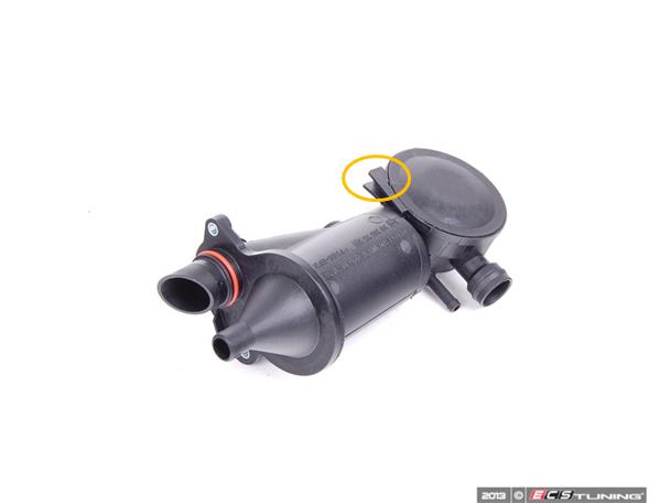

I just removed my AOS ('03 C2 coupe manual transmission) but I fought hard with two of the bolts - the infamous manifold bolt closest to the front of the car and the rear most 5mm allen bolt of the AOS. Any tips on tackling those? My problem is part of the AOS is sitting almost right on top of the intake bolt. Maybe less than an inch above it making sockets impossible. The 5mm allen can only be reached from the top by feel.
I could only put a 10mm box wrench on the intake bolt to back It out blindly (10 degrees at a time all by feel) but when I'm half way, the wrench itself hit the AOS and the bolt can't be unscrewed completely. Using an open wrench may have worked but very difficult doing it by feel. I ended up removing the two 5mm bolts from the AOS so I can lift the AOS and push it out of the way to expose the intake bolt. However, it took me quite some time to find the right extension u-joint combo to remove the rear most AOS bolt. I didn't want to use ball end allen afraid of stripping the 5mm bolt since I don't know how tight it's on.
Any better ways? TIA
EDIT: see photo below. The circled part sits almost right on top an inch above the  front most intake bolt.

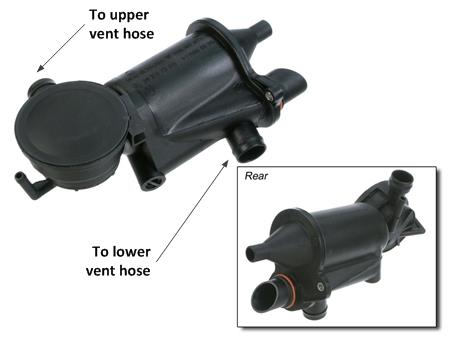

9. Disconnect the lower AOS vent hose using BOTH HANDS from the bottom
10. Move the vent line out of the way so it’s not blocking the rear AOS 5mm allen head bolt

20. Disconnect the upper AOS vent hose
21. Remove the 2 coolant lines from the AOS

Oh your AOS is the older version that doesn't have the u-channel as shown in my first post? No wonder you could use an open wrench on bolt #6 on the intake manifold. You should be fine using my steps to reinstall.

Btw, you just rediscovered the whole reason I started this thread. I had problem removing that bolt when the AOS was still installed. The u-channel of the AOS is blocking any socket on that intake manifold bolt. You could probably use a wrench but it will be very slow. So I unbolted the AOS and lift it up and that allowed me to put a socket on that intake manifold bolt.
Basically we have two choices, either fight that intake manifold bolt like you are doing now or fight the rear most AOS bolt when bolting down the AOS.
