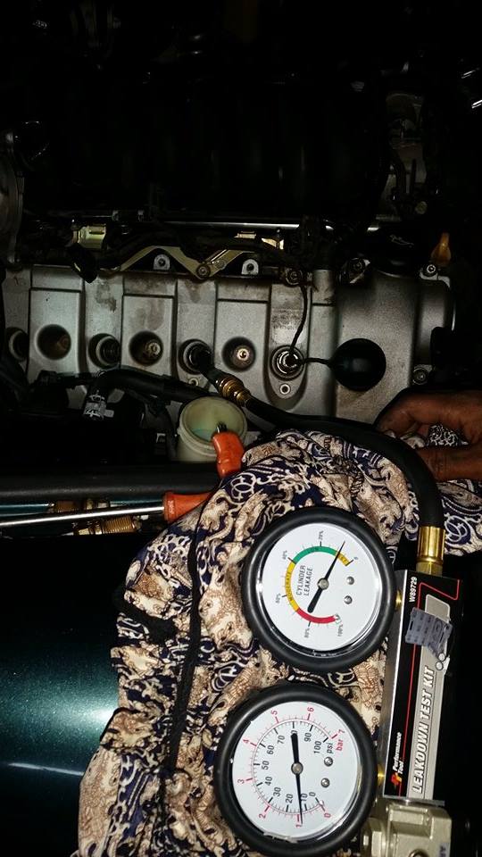

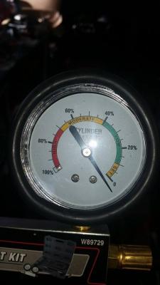

I bought a leak down test. I took out all spark plugs and the intake. I don't seem to have the right socket for the crankshaft. Anybody knows which size i need? I am trying to do it without taking out the bumper and cooling fan. I managed to test one cilinder so far and that one is fine as you can see in the picture i added.
I did by the way drop the coolant which seemed very clean to my suprise. Only the last bit was dirty.

If I am reading that gauge set correctly, you are seeing very low leak loss, but at about 10 PSIG.  You should be reading the leak percentage are much higher pressures (90-100 PSIG air).
Ok, according to the user manual http://www.northernautoparts.com/files/manuals/performance_tool/W89729_Manual.pdf
I think as long as you follow the following steps, set the air compressor regulator to 50-100PSI, and the tester works properly, then I think only the reading on the upper gauge (as % in your photo) matters. It's not clear what the lower gauge of 10PSIG represents. I think there's where the confusion comes from.
"6.  Set the air compressor’s regulator to 7psi to 100psi. Never operate tool with more than
 100psi inlet pressure or damage to the tool can result.
7. Turn the regulator knob clockwise until the cylinder leakage gauge reads “0” at the
 end of the yellow band"
No you are wrong, the lower the better, thi is under 10 percent so it's fine. Now up to the next one.
If the air inlet pressure to the tool is really at 10 psig (or less), I would not trust the results, regardless of how good they are.  Higher cylinder pressures will show the real leakage rates, not lower.
What is the compressor line air pressure going to the tool.
