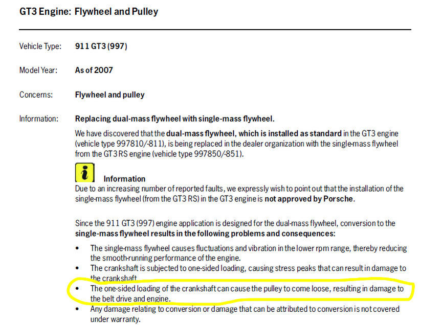

For those that question Porsche's position on this subject, here is a excerpt from one of several bulletins on the subject of using single mass flywheels in place of the DMF, specifically when using a single mass unit from and RS engine, which is subject to much more stringent engine balancing criteria on a non RS engine:
627108d1291833248-gt3-with-light-weight-
Over the years, there has been considerable speculation about why the DMF was used.  The most common opinion is that is was a packaging decision to add the dampening in the bell housing (where there is considerable room) rather than put the dampening mass at the front of the engine as most manufacturer's do.  While there is considerable room in front of the crank on a 986, you need to remember that the same engine is used in the 996, but facing the other way around with the crank snout  much closer to structural members and the like in the back of the car (something that anyone that has changed water pumps on both a Boxster and a 996 can appreciate).  Not wanting to have two different systems for these models, they came up with one solution that would work in both cases, saving a lot of money in the process:

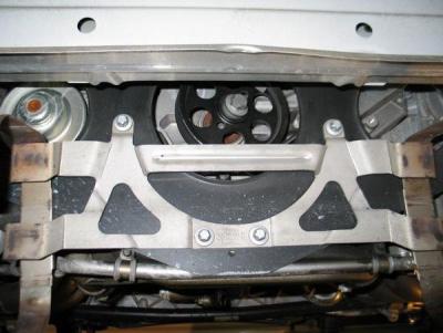

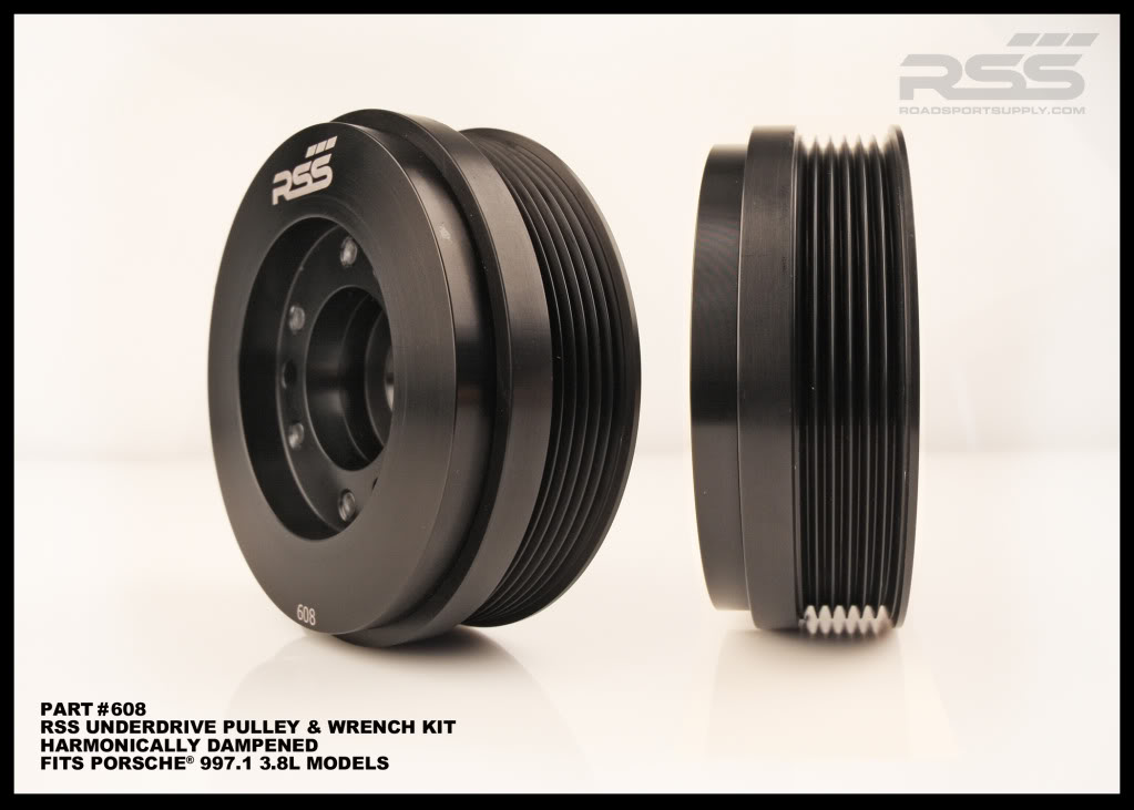

The two most common ways of dealing with dampening on these cars has been to rebalance the rotating assembly and lightweight flywheels (which is obviously not realistic for everyone), or use an after market front pulley assembly which has a dampening system built into it (this one happens to be for a 3.8L. but they also make other models as well):
These seem to help with the issue, but their size creates an entirely new set of problems to deal with (even on a Boxster, it is easier to fit one of these to the engine while it is out of the car).
Thanks JFP.  I actually know Mike at RSS.  They're walking distance from my office.  I'm gonna get some input from him.
