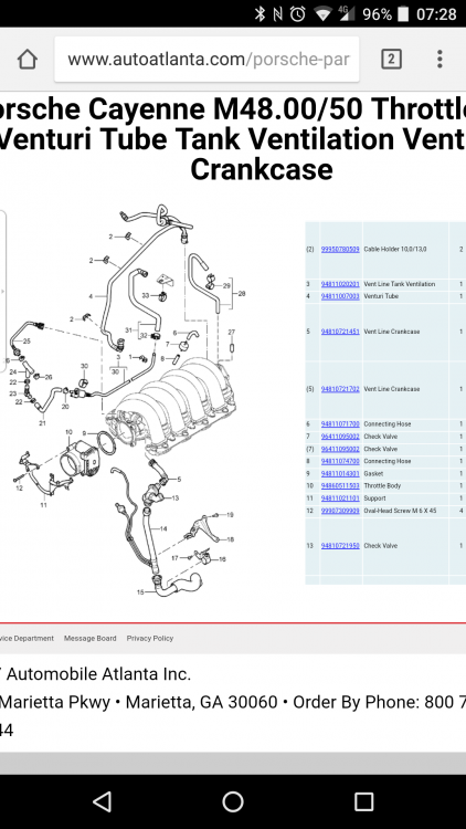

I was thinking it was EVAP purge valve. I put a clamp on the vacuum line between evap valve and throttlebody then went and filled up. Problem solved.
Have valve on order, around $130 and easy to replace. Note doing this will also cause evap codes but will start every time and run well.
The other thing I noticed was horrible fuel economy.

6 hours ago, bberryj said:
Hi Mattehlers. Do you happen to have part number for evap purge valve and location of the valve?
Thanks
Item number 3.
It sits about 6" to the right and 2" lower of the throttle body.
Hi Lewis. Thanks for the info. My vehicle is a Carter's S. in mattehelers post he said it was his 2006 cs. I guess that was a Cayenne. I didn't pay attention to the forum I was in. Still nice of you to help. My bad.
