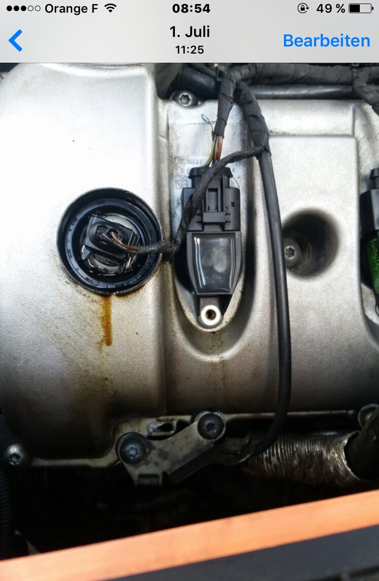

Not that i dont trust mechanics but today i checked what they did and surprise surprise.
The changed the spark plug gasket and valve cover gasket because i had oil in coil tunnel for cylinder 5. i take away the engine cover and take out all coils. What i found? Oil in coil tunnel number 7. AMATEURS or what should i say. Car is going back to service straight away.
  • 2 months later...
So the update on this story was:
they fixed the valve cover gasket in the right way, but they didnt fix the small gasket on this small valve which is sitting in front on top od the valve cover. Now its done. Maybe i am wrong but the loss of power situation i have came almost at the same time.

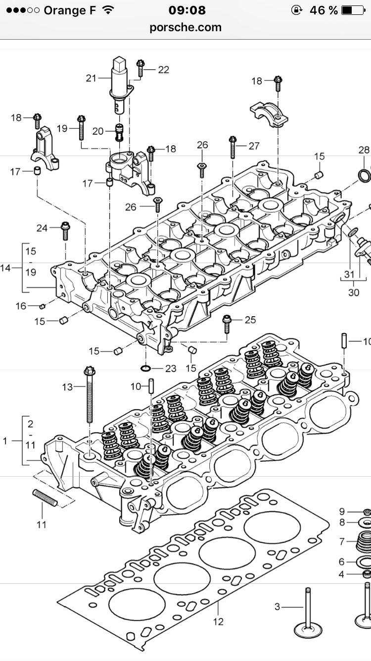

Would somebody tell me what this part is. # 21 on the picture i guess. Is it the camshaft actuator? What is this part doing? Could the do something wrong there?
Thank you
Edited by ekstroemtj
Thomas this is the camshaft actuator solenoid. And both of mine are leaking oil as well! Although nowhere near as much as yours, it's more a weep than a run of oil.  I wouldn't say your current running problems on the way to france are because of this but you never know. I'm going to try and change the oil Seals without removing the valve covers. If it work it will save me at least 5 hours or work to remove the valve covers and put it all back together. When I did the right bank valve cover gaskets it was a real pain in the *** to get at all the bolts near the rear against the bulkhead.

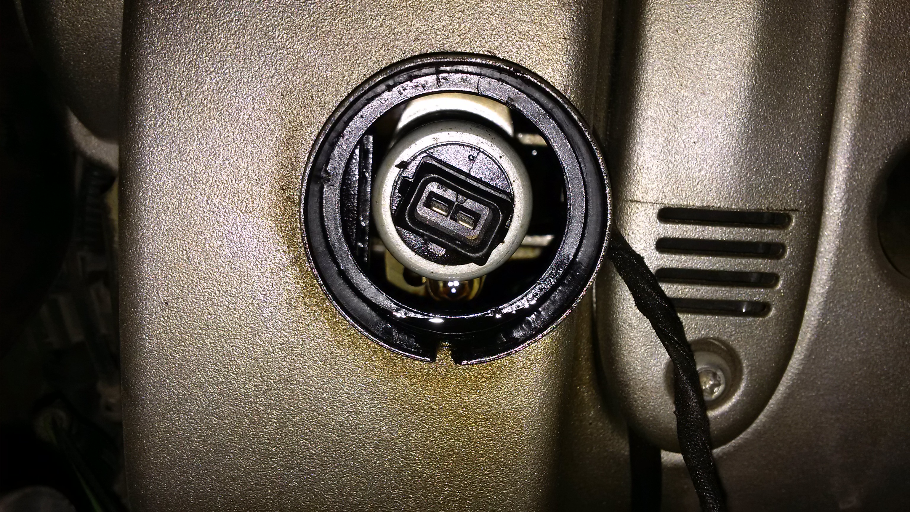

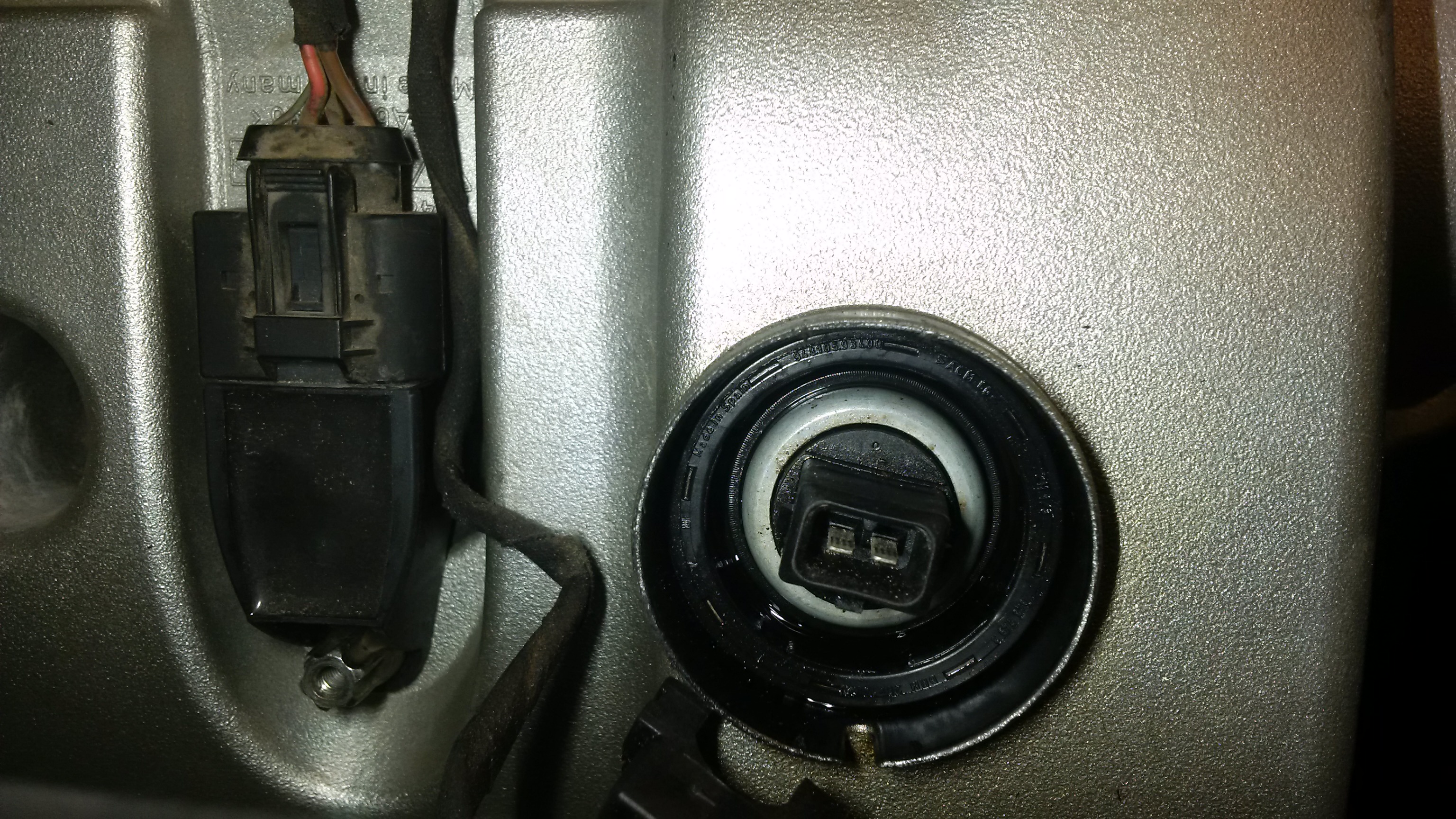

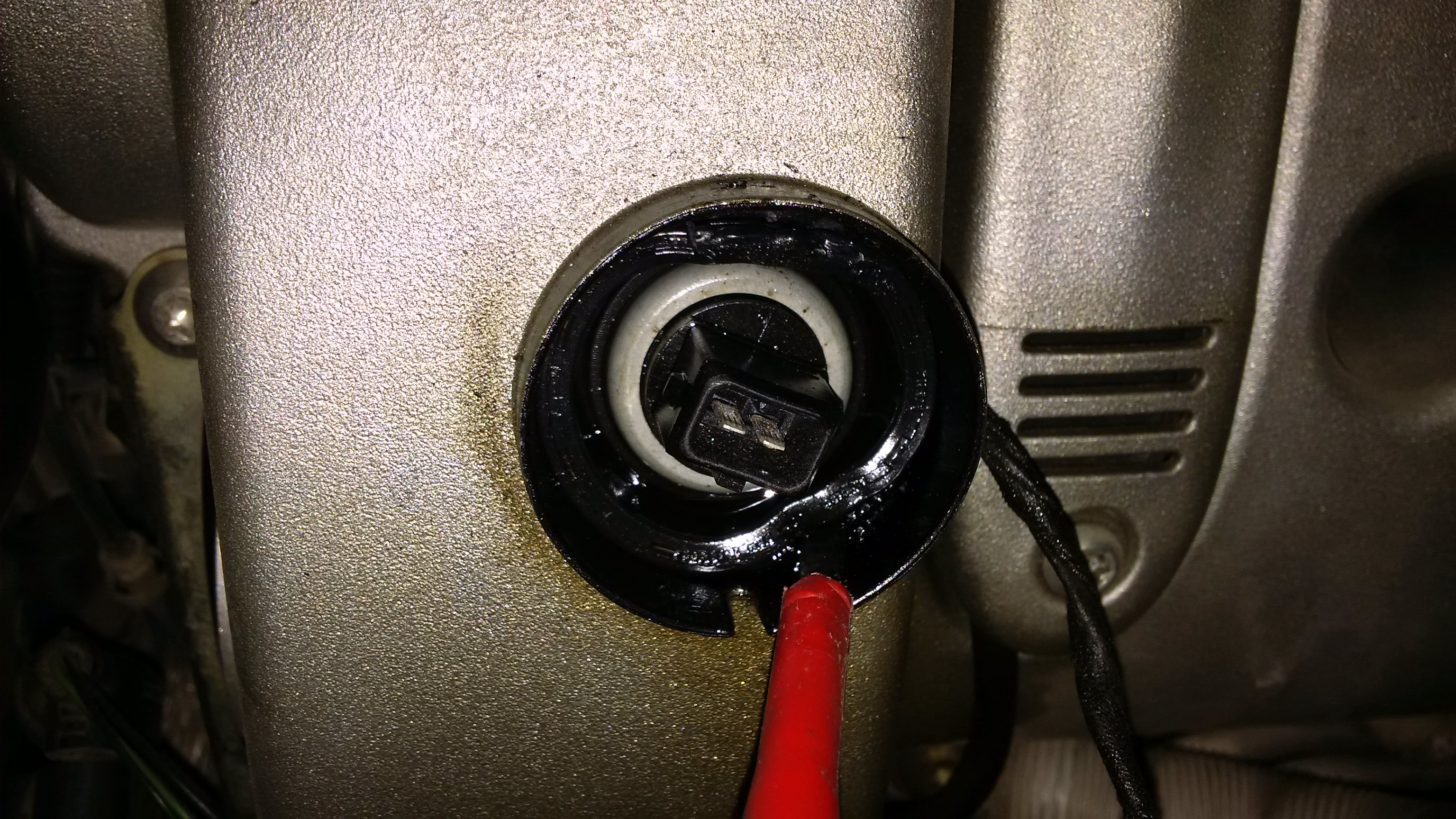

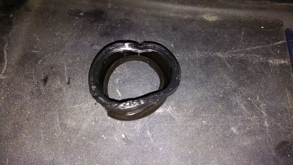

Thomas I got these oil Seals out today in 5 mins with just a flat blade screw driver. By wedging the flat blade in between the case and the seal and twisting the screw driver (do not lever, it will crack the valve casing) it will deformed the seal enough to pull it out easily.
I've contacted my seal guy and seeing him tomorrow to check if he has something that will work. If not plan B go to Porsche and buy.
Word of advise the way I did it WILL cause some scratches on the valve cover case where the seal seats. I will be reinstalling new Seals with a bead of gasket sealer on the seat before I install the new oil seal. I guarantee it won't leak after but still my disclaimer to anyone reading, don't blame me for the scratches caused by using the shortcut screw driver method to avoid removing the both the valve covers!

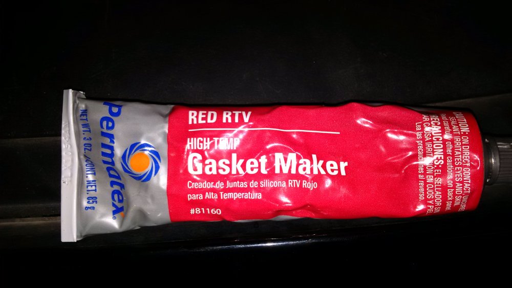

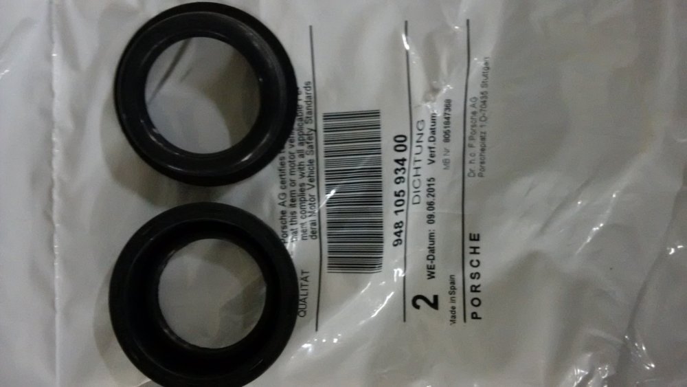

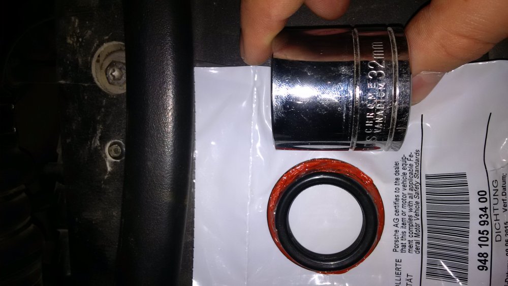

I did the actuator solenoid Seals today went really well and about 15mins work. I ended buying from local Porsche centre as I couldn't find anything generic in the market. $50 for the pair.
See pictures I put rtv gasket seal maker around the lip and used a 32mm socket to gently tap it into place, it actually goes in real easy. Quick wipe around and all done.
