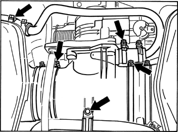

Removal
1. Disconnect battery and cover terminal or bathtery. Open engine compartment lid.
2. Remove air guide from between throttle body and air filter. Take out vent line from between intake distributor and oil separator.
3. Loosen both hose clamps at intake distributor. Unscrew fastening screws (M6) for fuel pipe at intake distributor.
4. Loosen bracket for throttle body on the crankcase. Swing intake distributor and throttle body upwards by approximately 45 degrees and remove bracket on the throttle body.
5. Loosen cable at teminal 30 (M8) and terminal 50 (M6) at solenoid switch. Undo both hexagon head bolts M10 on the starter and remove ground cable. Withdraw starter upwards from its bracket.
