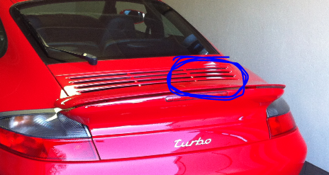

After I connected the battery terminals, and closed the bonnet, I saw smoke comming out the rear (RH engine cover side, blue)
Burnt electrical smell.
I was looking in the area marked with a pink arrow (pic from net, not my car).
I couldn't see any obvious signs of wire damage.
I didn't check starter or starter/solenoid, don't actually know where it sits.
I've since disconected the battery, and want to try and locate fault before connecting again; fear of doing more damage.
Any ideas ??
BR // Adrian.C

Anytime you connect a battery and get smoke and/or burnt smells, you are risking burning the car to the ground.  Something has shorted and is not going to heal by itself, you need to get the car up in the air and start searching for what got hot before even thinking about reconnecting the battery.
The engine bay 12V terminal is right there in the location you pointed out.  It's in a small black plastic box with a big + on it.  Pop it open and make sure the wires have not melted there.  That is the main 12V supply terminal for the starter.
