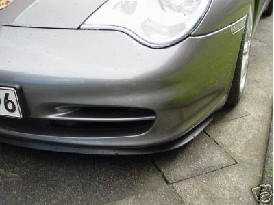

I was also curious about this Aerokit lip for the standard bumper, but nobody had a picture or so available.
I went to my dealer a few weeks ago, but he also has never seen it before. Since the price was reasonable (about 60$ here in Germany) I ordered it:
The lip itself is a 2 feet long piece of black plastic as TD in DC describes. It's about 1-1.5 inch deep.
You fix it at the standard >MY02 bumper about 4 inches behind the front 'edge' by clipping it into existing holes (better: slots). If you look under your car you'll easily see the mounting holes, so you can imagine of what I speak.
- It is definitly not the GT3 lip (neither the old one nor the new one)
- You hardly see it after it's installed because it's not sticking out from the bumper, but hidden under it.
- It's (to Porsche standards) cheap, but IMHO still not worth the investment.
So if somebody finds a nicer, better solution (TomSch, when do you finally install yours on your Targa? :D ) I am very interested in seeing some pix.
Wolfgang
PS: there is one sold at ebay (Germany) and the guy says it fits to 996/2. Anybody installed this? Is that a Porsche part?
