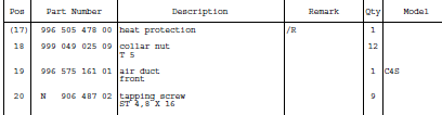

My info is all 996 so the 997 could be different, but I think the part you are talking about is Item 19 in this diagram.  I have also attached the page with the p/n, which notes as being for a C4S (these have a center radiator, right?).  My '04 996 had evidence of having had this piece installed at one time but I don't know why, since it is a C2.  I hope this helps you get some info on this.
If I were you, I would just buy this part and replace your damaged one.  As you have agreed, Porsche put it there for a reason.

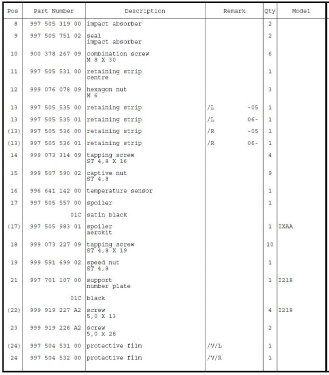

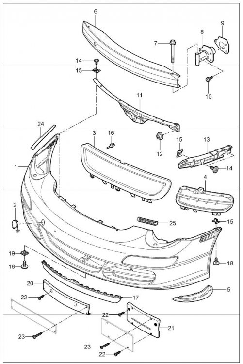

Thanks for putting all that effort in trying to help me out -- it's much appreciated!  However, I think that the 996 is a bit different from the 997.  After much searching (and hair pulling), I have finally found a parts diagram with the part in question.  The part that I lost on some speed bump was what Porsche calls the "spoiler" (part #17), see below.
Thank you everyone for putting up with this search.  Maybe it'll help someone else as well.  I'm under the impression that this is what these forums are all about...
