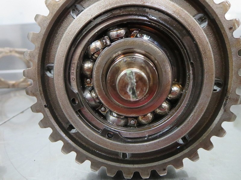

Jake Raby called me today. He thinks it's an IMS Bearing failure. I just signed an Authorization for him to remove and inspect the motor.
Share this post
Yikes!! So the larger stock bearings do fail too although not nearly as common as the smaller bearimgs.
Hope most parts are salvageable.
Share this post
No damage to the block or heads. I am going for the full reconstruction and increasing performance to Jake's "Performer" Stage 1 motor. Jake is inspecting the failed IMS bearing and shaft very closely. This is the first 997 street car he has seen with the IMS bearing failure.
Share this post
Very nice with an upgraded engine. Just wondering how many miles on the engine and any mods on the IMSB? For the pics, looks like it's been taken care of very well.
Share this post
98K on the engine, no mods on the IMSB. I use Red Line 10W40 every 3K miles but I am not the original owner. I have owned this car for 3 years and put approximately 38K miles on it since I purchased.
I will let you know what Jake finds... He is investigating every part of the motor.

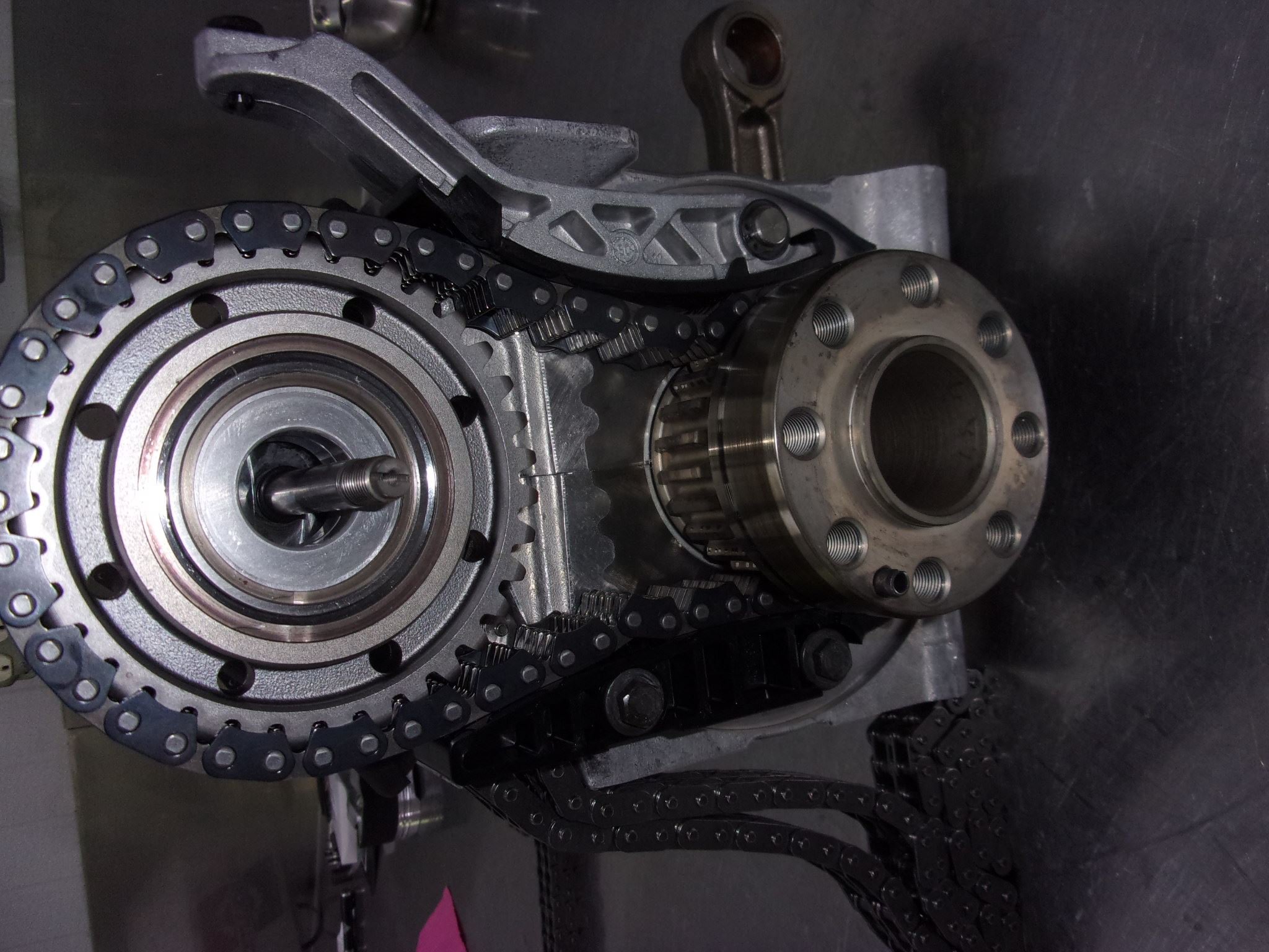

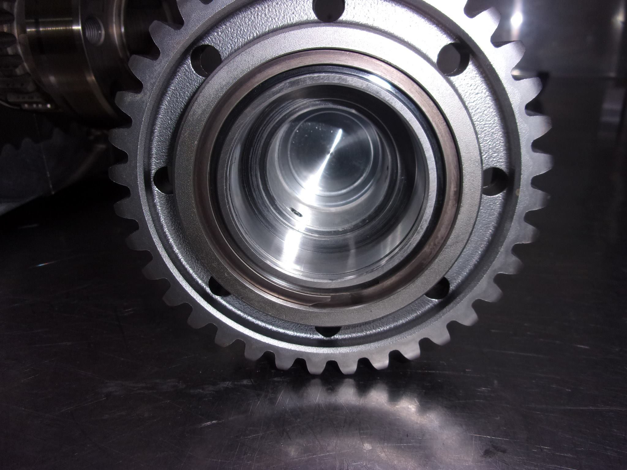

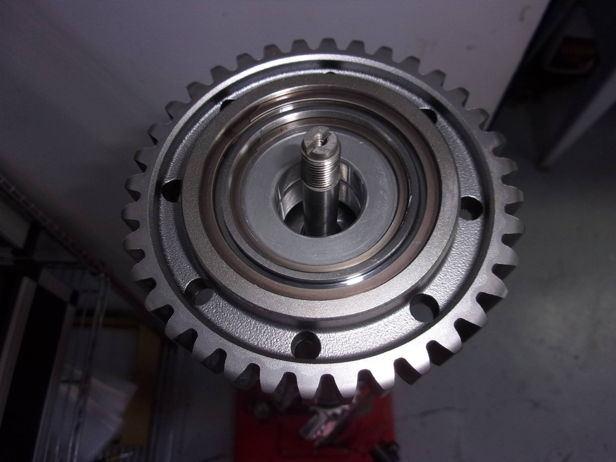

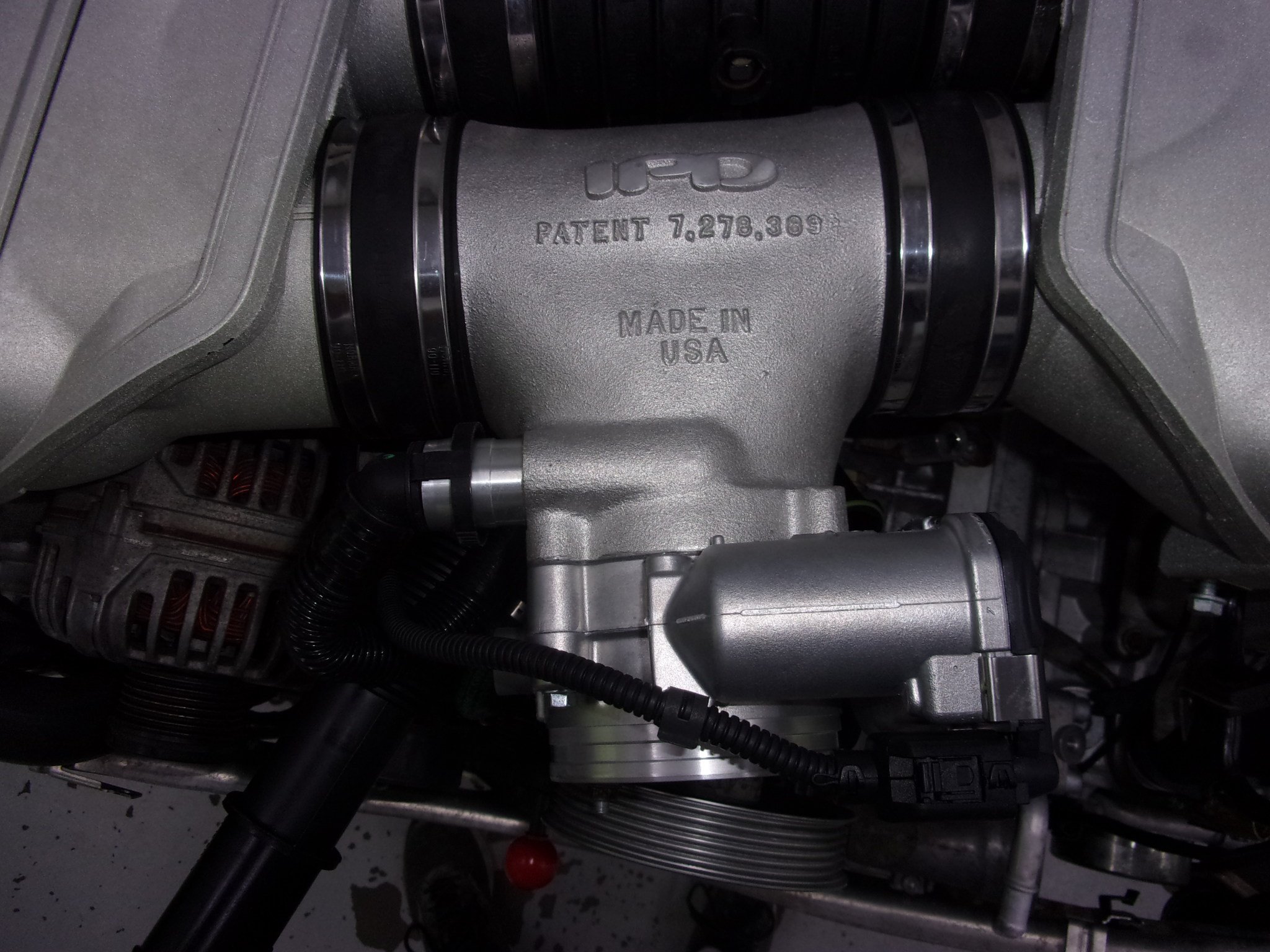

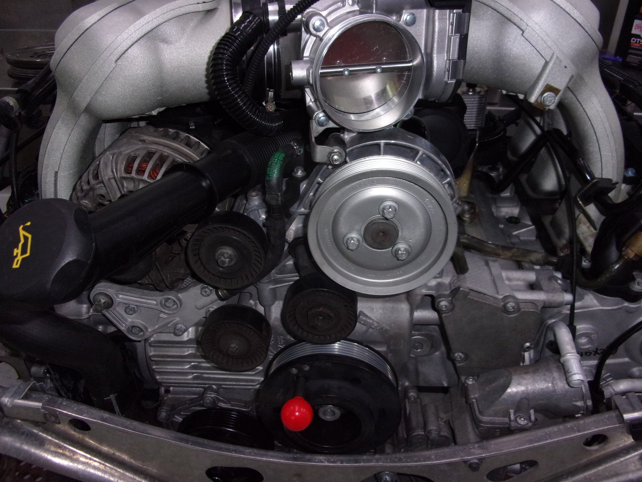

Just got a message from Jake Raby... They started the motor today, all is well. Testing and tuning the rest of the week. Here are some more pictures:
Notice the GT2 Throttle Body and performance Plenum.
