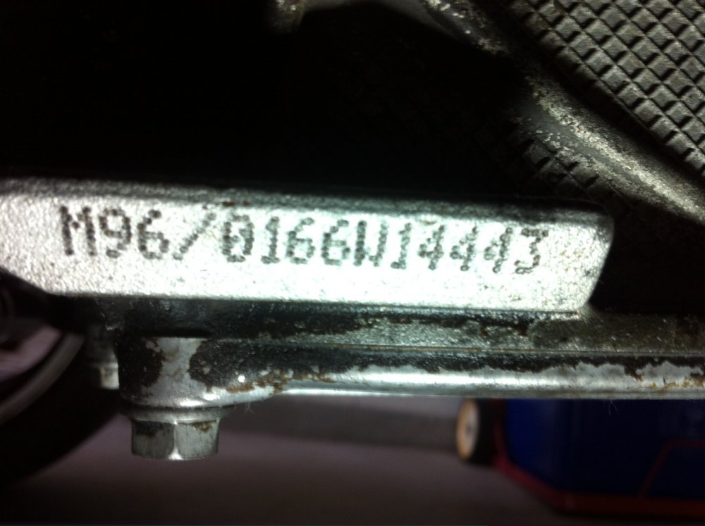

Engine number is on the drivers side next to the oil sump pan...like this.  You are correct.  2000 was a transition year for the IMSB from the dual row bearing to the smaller single row bearing.  As far as I know, on a 2000, there is no way to know whether it has a dual row or single row bearing by using the engine number.  If it were me, I would just plan on having the LN IMS Solution installed as soon as possible.  No sense in pulling the bearing and replacing with another bearing that will need to replaced again in 36-40K miles.
3 hours ago, Fly Navy said:
Probably stupid question but where is the engine number?  I have 2000 996 with 58K miles and am trying to determine likelihood of dual-bearing IMS.  2000 was the transition year.  So thankful for your help.
Welcome to RennTech :welcomeani:
Unfortunately, as noted above, 2000-2001 were transitional and could have either a dual or single row bearing.  Equally unfortunate is all the internet garbage about being able to determine which style bearing would be in an engine of this vintage from engine numbers, VIN, production dates, phase of the moon when the car was built, etc.; all of which are complete nonsense.  The ONLY to know which style is in the engine is to take it apart and look.
