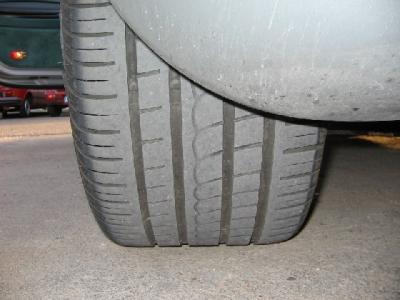

I post the tyre status for you to see if this could be the reason.

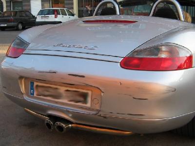

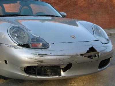

It looks like you will need a new front bumper ($300), a headlight trim piece ($30), and a new paint job to the rear ($500?). Shouldn't be a lot.
You could take this opportunity to get a 996 front bumper or a 3rd party item.

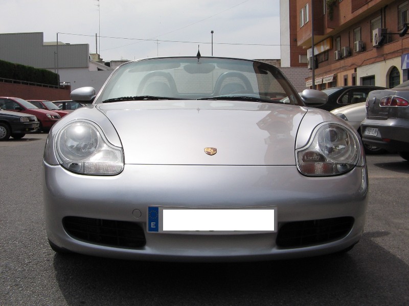

BTW, your front bumper doesn't look like an S item.
I thought you said you car was a 986 base model? To each his own but if that is NOT a "S" model which it doesn't look like you really will be looked down upon in the Porsche community for slapping on a model designation that the car is not. My first mod would be to either take that "S" off or take the entire model designation off. Very poser-style.
As for your accident. It appears that it is just cosmetic. New bumper, paint, etc. should be under $1K especially if you buy the parts used.

Your rear tires are pretty shot. To be honest, the P-Zero Rosso is a pretty mediocre tire to start with and by the time they get down that close to the wear bars, even on dry roads they are way past their best.
Having said all that, the reason you went off the road is because of driver error. Did you go into the corner too fast and lift off the throttle? That will induce a spin in a heartbeat. Did you go into the corner too fast, feel you were going off the outside of the corner and turn-in more or worse jerk the wheel? Notice the common theme. You entered the corner too fast. You should not lose faith in the car, but your ability to drive the car - sorry to state such a blunt truth! Traction control will do nothing to stop a spin. It's not like PSM (Porsche Stability Management) that monitors steering input, individual wheel speed and vehicle yaw and will detect a spin and attempt to correct it. Traction Control simply monitors the difference in speed between the front an rear wheels and attempts to reduce rear wheel speed if it detects too large a difference.

With regards though to your rear decklid......You really need to remove the "S" from that car. Nothing worse than applying a badge (emblem) to a car that it is not and looking like a poser.
Looks like quality work.
