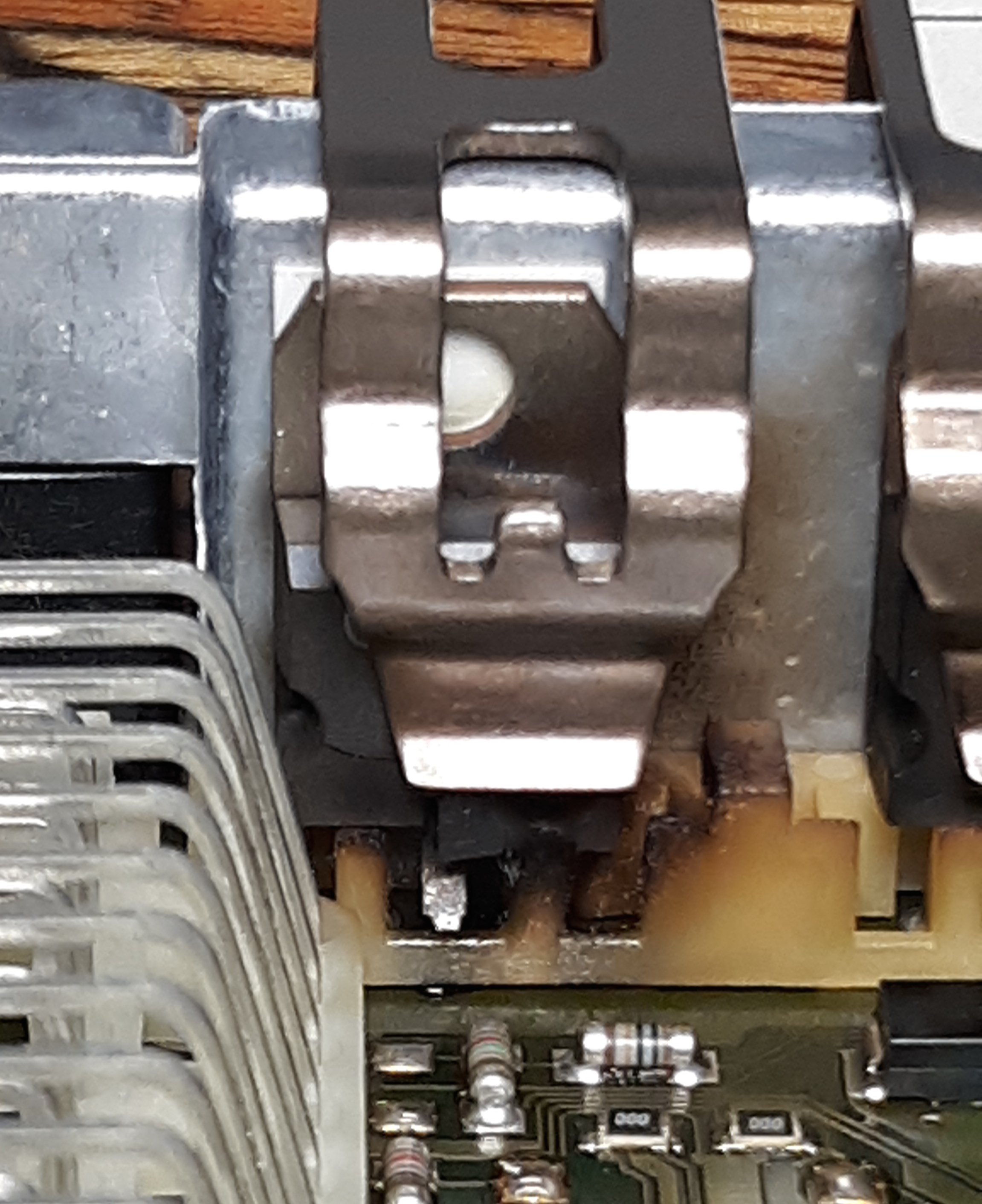

Viewed other threads and pix of burnt components in the DME....pretty obvious. Is there any harm in unplugging the DME and taking a look see inside? Is it a transistor or resistor that's in question?
As long as you disconnect the battery first before removing the DME, you're fine. BTW, to test the DME is good, the easiest way is to unplug the solenoid and plug in a small 12v 5w bulb, then use Durametric to trigger variocam and the light bulb should light up. That way you don't need to remove the cam cover and solenoid. See the details in this thread where I helped another gentleman.
It's a bipolar transistor. Spec is here.
Edited by Ahsai
Share this post
Then it would be tough to troubleshoot. I guess you could still open up the DME and check. If there are obvious signs, you find the culprit. If there's not, then it's still not conclusive...

Lo and behold. Well I opened up my DME and found an obvious fried Transistor, would this be the root of my problem? Hopefully!! There was another thread with the replacement part number can't seem to find it. Any help as to where to purchase the replacement transistor would be appreciated. I'll post another pic. Thanks V
Share this post
Bosch BIP373 Coil Driver Mod Kit from DIYAUTOTUNE is the part I need? It comes with a resistor but not too sure if I would use it. Thanks....looking forward to resolving this. V
Share this post
Numbers on the transistor 30046
                                                44313.1 any other numbers are burnt and cannot be read useless the chip next to it is the same and can be used as reference. V

Glad that was it. All the info you needed was in the thread mentioned a few posts above with pics too.
Yes, get the 373 and you are good to go.
Share this post
You don't need the resistor from the kit. Just replace the 3 pin burnt transistor and you should be good to go.
Share this post
OK ....resistor not needed thats what I thought. ....so replace with the 373...you think that was the problem....would that allow the actuator not to engage ?? Thanks again for your input ....big help. Vince
Share this post
Well, a burnt transistor likely won't be able to supply the ground properly to the solenoid so even a new solenoid won't help. Whether this is indeed the problem depends on how the tech tested everything before when he told you the solenoid got power, like I explained before. If he only testes for the 12v but never the ground side, this transistor is likely your problem.
However, if he indeed tested the ground side and verified the solenoid has power, then it's likely the actuator itself.
