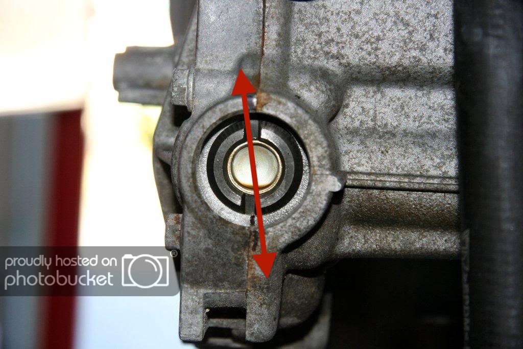

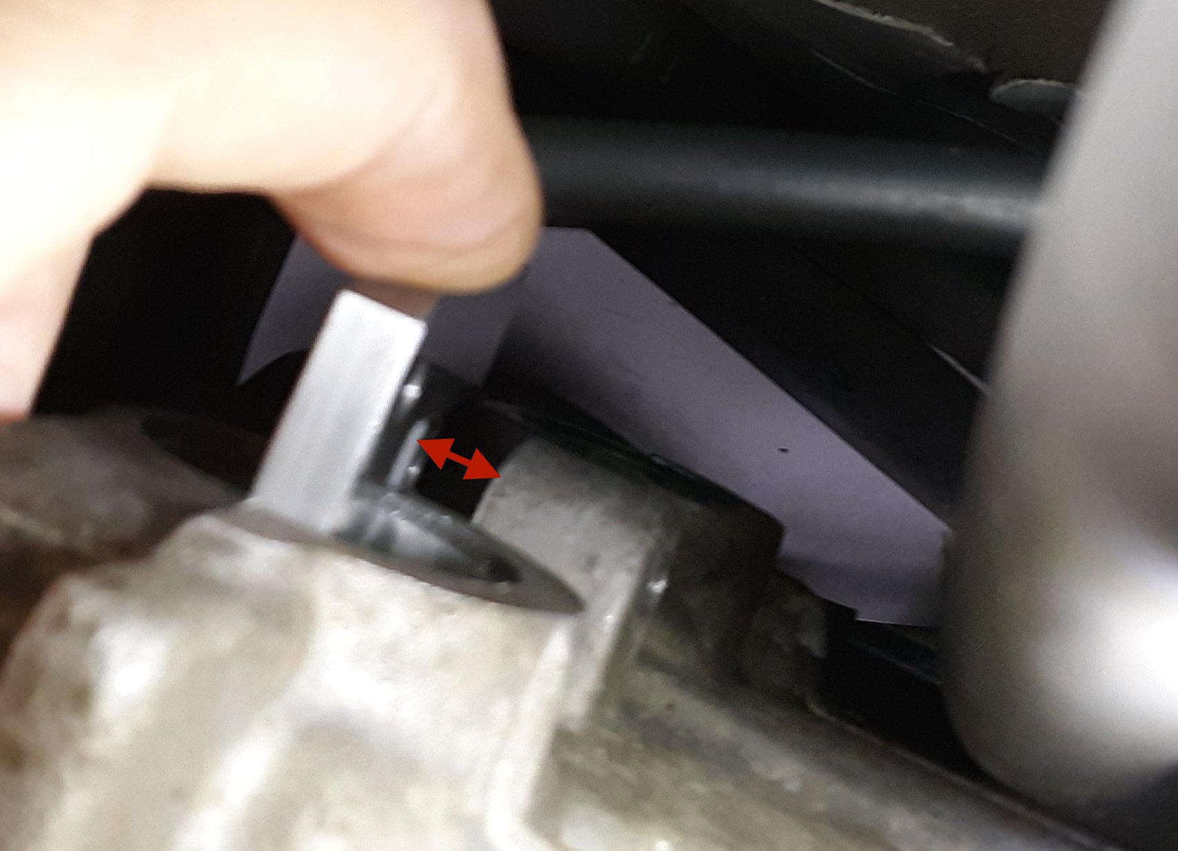

OK...so good news I guess...you were correct in checking the timing ....it did move again. Cam is rotated too far counterclockwise if that would confirm a negative deviation value. Does the oil need to be drained to pull the scavenge pump and replace the tensioner? (probably so) would be easier to leave oil in, adjust timing,replace tensioner and start it up. Does having 0 degrees deviation insure the cams are timed correctly? The pictures posted show the 'puck' inserted on the exhaust cam, if you look closely you'll see my scribed line and see how much it's off(does this represent 7.5 degrees?) with the seam. The other pic shows the locking tool and how far it's off from the treaded bore where the bolt goes. I assume the tensioner I'm replacing is the one on Bank 1 located underneath the scavenge pump. I don't plan on pulling the cam cover so I won't be able to check the links or dimples on the cams. I'm going to go for just a re-time then lock down the cam and replace the tensioner on Bank 1 side (cause I guess that's why I may be losing the timing....twice now) and see if my deviation gets straightened out.

If you shifted the grooves counter clockwise to line up where the arrows are in the pic below(stock photo) that would be where my timing is now for Bank 1.
Just to clarify.

Based on your description, your cam is lagging behind the crank because the engine rotates clockwise and that:s exactly why the cam devitaion is negative (lagging). It does look like 7 degrees or more off to me. You can estimate. A full circle is 360 degrees...

OK....so it looks like that is the problem.....the timing. It looks like 7 or more degrees on the pic dosen't it!! The tensioner I would replace (because of the loss of timing and the chain rattle) would be the the IMS tensioner as mentioned (maybe getting weak or worn). Just confirming. I had hard time getting the scavenge pump back in last time. Is it ok to back a few of the cam cover bolts out(near to the pump) without the risk of breaking the seal on the cam cover creating a leak. What do you think?  OK I'll give it a try. See what happens!! Thanks V

Yes, that slot is a mile off where it should be. Cam deviation readings don't lie.
