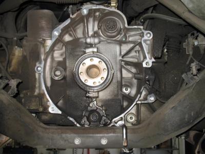

On my January 1997 Boxster I had my clutch replaced 3 weeks ago by Marvin Weitz who owns an independent shop. Marvin worked at 2 local dealerships before going independent.
Before the transmission was remove and the car was on the lift I could see there was some seepage. After the transmission and flywheel were out I went back to the shop for another look and took the picture. There was a film of oil on the back of the engine case. It looks black in the picture because clutch dust sticks to the oil. Could not really tell where it was comming from or if it was comming from more than one place.
I consider this minor to normal for an engine with 67,000 miles. In 9 years of ownership I never saw an actual drop of oil.
I had to make the decision to try the latest reseal procedure, or just replace the clutch and put it back together. I believe in Murphy's Law - if it ain't dripping leave it alone.
I gave it some thought and also talked to Peter Smith. Then I decided to have it done. Flywheel was out anyway and I had 67,000 miles. Plus my Boxster is so old I had the original style intermediate shaft flange seal.
So Marvin replaced the rear case bolts with the "blue" sealing bolts. The intermediate shaft flange/seal. And I got the 4th generation Cayenne style seal.
Time with tell if I should have followed Murphy's Law or not.

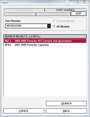

I hope I'm not repeating a post from someone else. (You try doing a search for RMS!!)
I see that the 997 seal has been updated! The latest number is 997.101.212.01. Must have happened quite recently.
Richard,
The parts list current only shows the 01 seal for new Cayennes and 997-2. It is not listed for 9x6 series cars (at this time).
Richard,
You are right - if you dig down in the listing for 996 or 986 it now shows (use 997.101.212.01).
I guess you should not always believe the ATP.
Loren
You might want to check that yet again! It looks like the 997.101.212.01 seal has disappeared from the latest 9x6 PET parts listing. Very strange.
