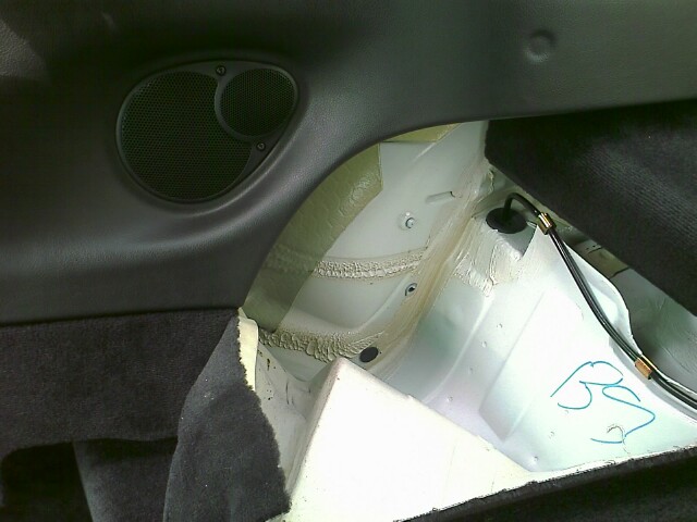

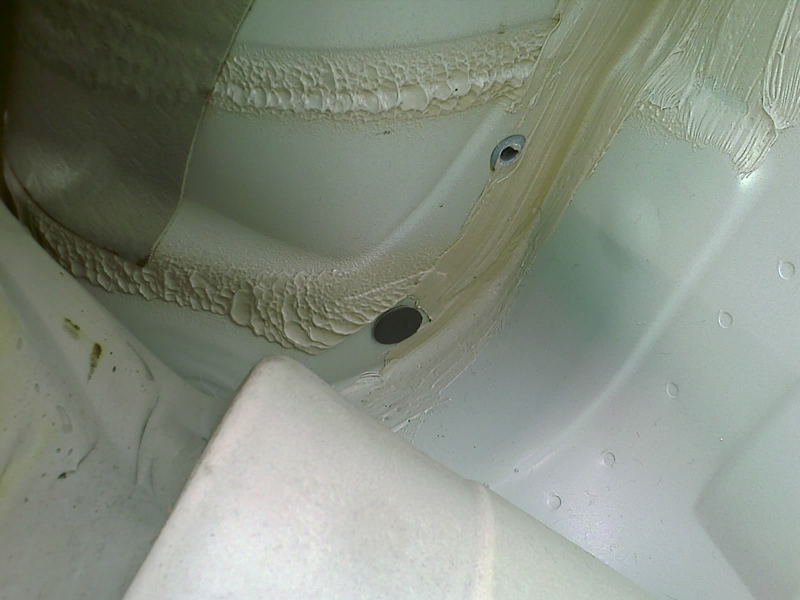

GT3 plugs: rather than cutting the carpeting to get to the plugs, I found it much easier to pull the carpet back; although you will still need a razor blade to cut the carpet later so that the rear bar mount bolt can be passed through the carpet. To expose the plugs, you need to just loosen the side panel (which you should already have done as part of the cutting of the rocker plastic under the carpet) and pull the carpet down from the corner of the rear compartment where the top of the seat back would be if the GT3 had rear seats. Then, it's relatively easy to unscrew the plugs (see the black circle below the very center of the photo). The plugs are friction plugs and can be ripped right out without damage to the car but they are easiest to get out by unscrewing. The carpet lays back down in its original place without any trace of disturbance.

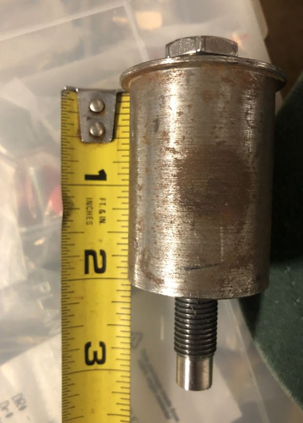

George, I am having the same problem. I cut the plastic side panels and re fit the carpet, but the bar attachment point nearest the driver seat doesn't seem to catch the threads.  It is a 2.75" bolt.  But not threaded all the way to the end. Just threads starting about 3/8ths of an inch from the tip of the bolt.
What did you do
FYI Rentech, I purchased new bolts about 1/2 inch longer from Fastenal.  Grade 8, 7/16 Fine thread, they caught the threads just fine and Bar is now installed. My theory is that i may not hve cut enough plastic out of the side panel. I used the template but. . .
