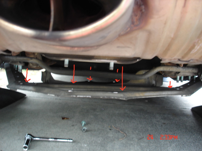

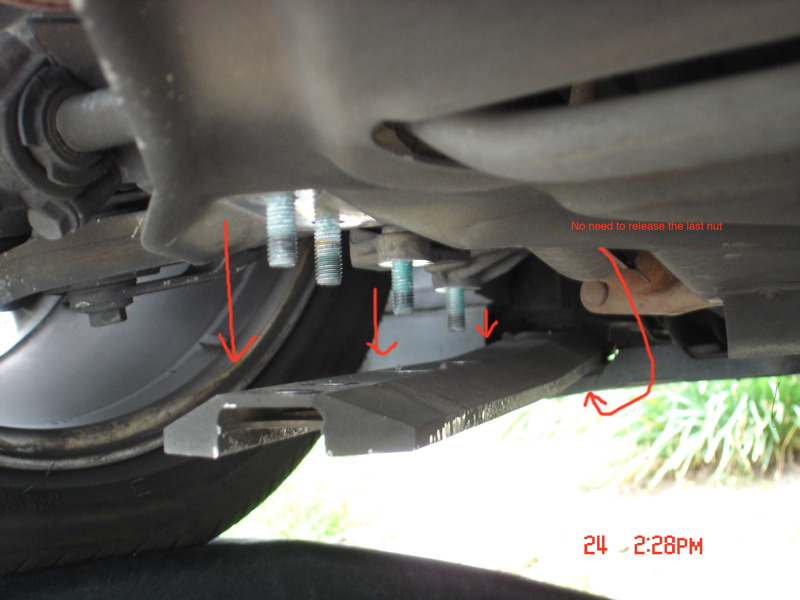

  2. Remove underside panels to access the transmission. (Boxster owners you need to loosen the diagonal braces and then remove the transverse strut member. A little more work on a Boxster. When you put them back they need to have the bolts torqued to 48 ft lbs. (65 nm). See images Image 1 Image 2 Image 3 Image 4 Image 5 ) (images courtesy of scherb)
