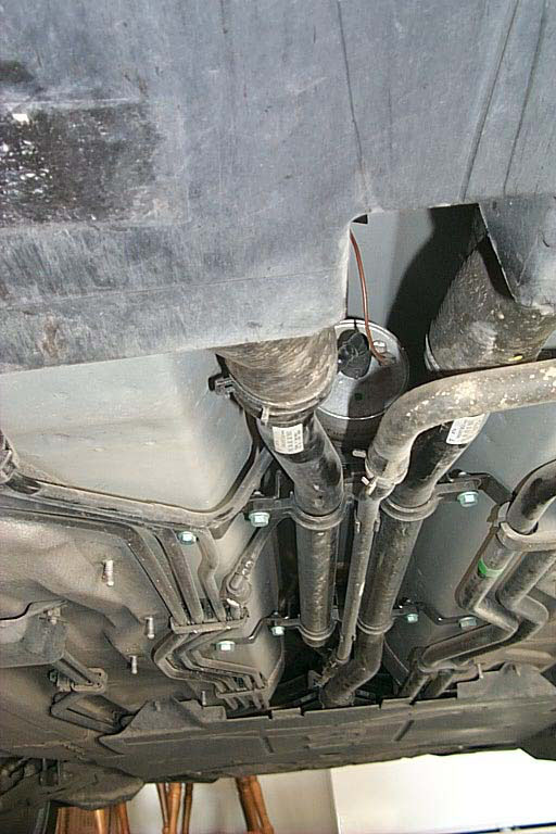

Note: Part numbers sometimes change without notice. Always double check with your supplier that you have the latest part numbers.
Parts you will need:
1 996 110 253 01 Fuel Filter - for 2WD cars
or
1 996 110 253 52 Fuel Filter - for 4WD cars
Tools you will need:
Tire ramps or jack (and jack stands)
Various screwdrivers to remove underbody cover
The fuel filter is located in the tunnel area facing the center unit above the coolant pipes (up to and including MY01). MY02 and newer cars have the fuel filter incorporated in the fuel pump - and usually does not need to be changed. This DIY is for MY01 and older cars.
  1. Remove cover for rear and center underbody. (photo courtesy Tool Pants)
  2. Pull off ground cable on filter. Then release the rapid-action couplings by pressing on the grey surfaces and remove the fuel lines. Collect emerging fuel.
  3. Loosen the large hose clamp on the filter and remove the filter element.
  4. Re-install a new filter element and tighten the hose clamp.
  5. Join the rapid-action couplings of the fuel lines. The plug connections must engage audibly. Then push the ground cable onto the filter element.
  6. Replace the cover for the rear and center underbody.

I attempted to change my fuel filter in my 2001 C2 and I guess the picture shown at the top of the post is after the transmission bracket was removed. This is the most service unfreindly installation I have ever attempted. Finally after not being able to remove the ground wire off of the lug, I surrendered and reinstalled the under tray panels before I broke something. Any tips/photos on actually getting the old one past the coolant pipes and the new one back in. No wonder they made in non serviceable for 2002. Car has 48000 mi and I am doing all the fluids and filters, guess I may have to go to a dealer or indy shop.

I replaced the fuel filter on my 1999 C2 yesterday and the ground wire was difficult to remove. I cracked the plastic cover on the connector using long nose plyers and a screwdriver to remove it , but it's still useable. The filter can be removed by passing it through the tunnel to the rear and squeezed between the rubber coolent tubes were they bend up to the engine.
