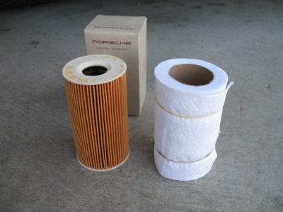

Time to pick an oil filter for my unapproved oil change.

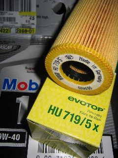

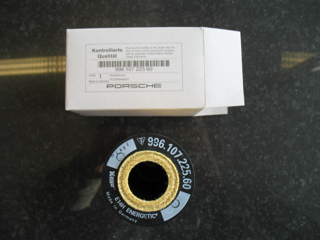

The oil filter sold by Porsche is made by Mahle. http://www.mahle.com/ I have some old stock Mahle/Porsche filters used for the pictures, so the part numbers may have changed a bit.
Wix has come out with an oil filter for our cars. http://www.wixfilters.com/ I wanted to try this filter. So I bought it.
From left to right. Wix, Mahle, and the Porsche branded Mahle.
This is from the top, except there is no real top or bottom for any of these filters.
From the side. They all have a nylon cage inside.
The Wix has an o-ring to seal the top and bottom of the filter. The Mahle/Porsche has a paper-like material on the end-caps. The holes on the Wix filter look a bit too large - I will know for sure when I put it in.
The Wix filter is made in South Korea. The Mahle/Porsche in Austria - until it gets outsourced.

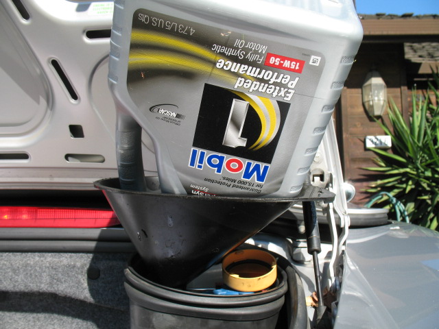

Back to my unapproved oil change. I finally found the time to do it.

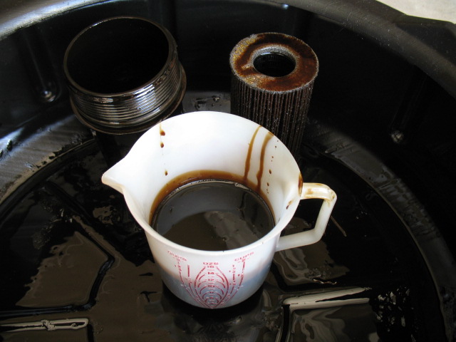

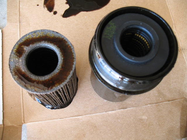

I like the Wix filter. I stuck it in the bottom of the cannister for a picture and it seated right into the valve. I do not do it that way with the Mahle filter. The Wix plastic end cap and o-ring seated so well that I just screwed the cannister back in by hand and the cannister bottomed out like it should. The Mahle has a paper-like seal and I would stick that filter up in the engine before screwing on the cannister.

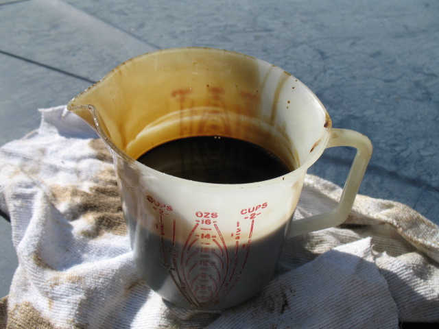

For you overfill freaks, I measured about 1 1/2 cups of oil in the cannister with the filter in in the cannister. That is the reason for the white measuring cup in an otherwise empty drain pan.
So, close your eyes. 9 quarts of 15W-50 are in my car. And I did not replace the o-ring for the cannister or sealing ring for the drain bolt, or use a torque wrench, and this is the third oil change on MY CAR.
16k miles. Still tasted good. Ok, I'm not going to Porsche heaven. But Porsche now says 20k miles on the 987.
The Wix filter was $19.95. You can find a Mahle/Porsche filter for less money. I wanted to try the Wix not to save money, but to try something different. Too bad I do not have a way to determine if they perform any differently.

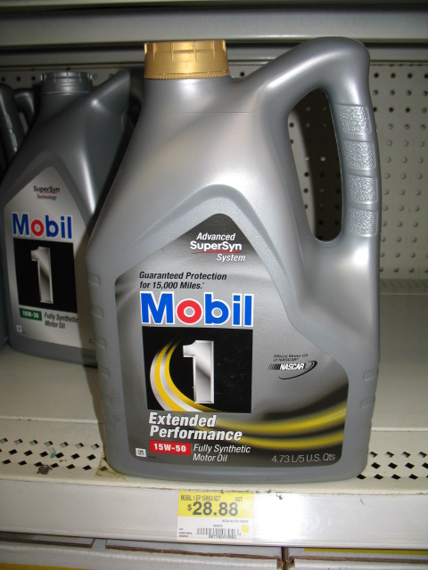

I see you went all out, and used the “extended performance” oil with the cool Gold cap, that costs more. Are you going to try to make it to 20k before the next oil change?
I can’t find specs on Mobil1.com to see the difference, they only list one type, I think it’s the extended, The price at the store for that Gold cap is a few bucks more. Wal Mart carry’s both types by the way, and two of these containers are just about right for the P oil change, and cheaper buy bulk container. Where is Costco when I need them? Let me know how that WIX filter works out, I have been using them in all my other cars for years now.
scotto :clapping:

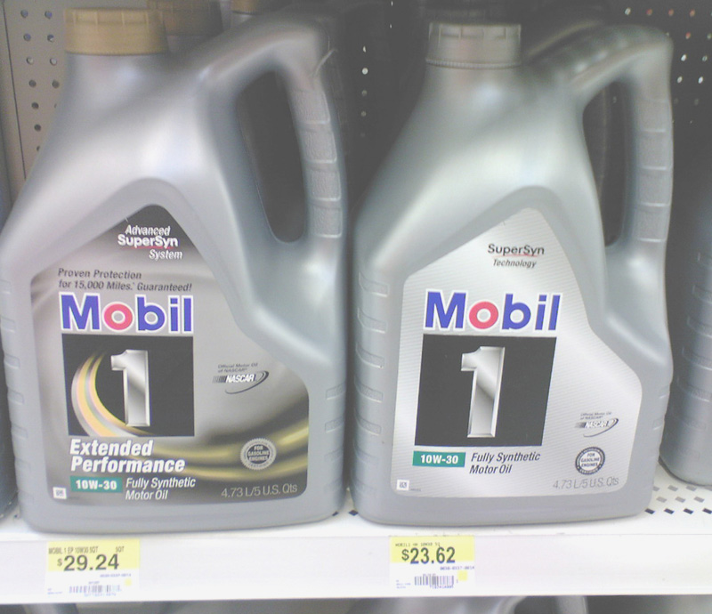

In your picture the container on the right with the silver top in 15W-50 is not something that I have seen on store shelves. Guess that is why it says New! On the Mobil 1 site it says back by popular demand. http://mobil1.com/USA-English/MotorOil/Oil..._1_15W-50_.aspx
The silver top was for a different weight oil. The original original 15W-50 had a red top. But then Mobil likes to change containers from time time. I am now an EP man. Cost more than the standard Mobil 1, but I spare no expense on the Boxstir. And my 1997 needs all the SuperSyn I can get.
