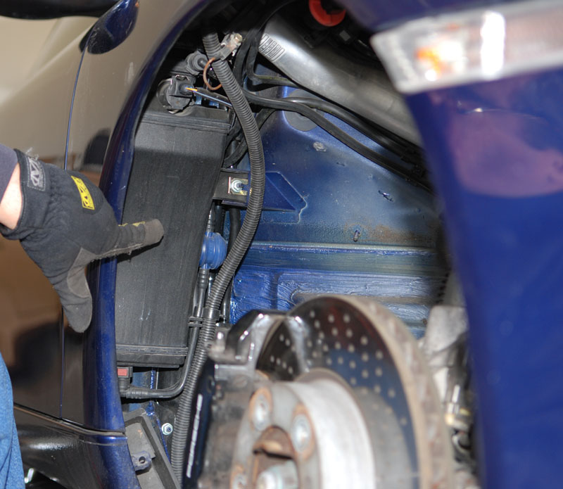

I got to looking at the evap canister this weekend with the idea of blowing out the purge air line. However, my Evap canisister did no match the diagrams provided in other forum discussions on this topic.
The diagram showed one line on top and two coming out the bottom. My cansister has three lines coming out of the top. Which of the three lines is the air vent to blow out? (left, middle, or right, looking straight at the cansister from within the wheel well)...? Two of the lines leave the cansister and are routed back toward the fuel tank. The third line (right) goes from the cansister back toward the front/top of the wheel well to a "block" with two lines going in and out of it...(appears to be the shut off valve housing, as again, unlike the diagram, my s/o valve appears to be separate from the canister....
I blew air into two of the lines but based on the bubbling sound appeared to be pushing air back into the fuel tank... HELP!

No it does not. My canister has no lines coming out of the bottom. There is one smaller line (approx OD 3/8") are two "big" (approx 3/4" OD) lines, left to right, respectively, coming out of the top all in a row.

Yes, take the liner out. It will make it easier.
There's really no way to disconnect the other end, as there's a valve on the other end. And, from what I've read, you can blow this line out either way, from the front or the back. However, I would blow it from the EVAP canister side. It's my opinion it's better to blow out in the direction the air would be flowing. And, if you do dislodge anything, it'll blow into the intake system and be burned during combustion. If you blow from the engine side, if there was a blockage, you'd just be blowing it back into the EVAP canister and it might block the line again.
