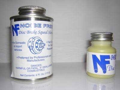

I use anti-squeal compound (in spray form). I bought one bottle of the stuff 10 years ago and I still have plenty left even after installing several sets of pads. It is easy to apply and my brakes never squeal or squeak.
Same here...The annoying high-pitched screech that's sometimes heard when braking. A common ailment on many disc brake-equipped cars, it is caused by vibration between the brake pad and rotor. Squealing noise is really a high frequency vibration. Brake squeal can be eliminated by installing shims on the backs of brake pads, by applying anti-squeal compound . By doing this we can create a thin cushion barrier between the pad & caliper(to absorb). I use this product called "Noise Free Disc Brake Silencer" with my Mintex . Silicone based compound is designed to absorb the vibrational energy that causes brakes to squeal. My baby never squeal or squeak.
I agree. The squeaking is NOT from the friction surfaces so chamfering or filing down the pads will do nothing for you. The outside surfaces of the pads are not perfectly parallel with the piston surfaces so when you brake and they engage, they squeak. Having a thin cushion between them (as juniinc stated) is the only way to prevent squeaks. My question is doesn't this layer make your brakes less responsive by being squishy? Isn't the reason we bleed the brakes is to remove air and make the brakes less squishy?
