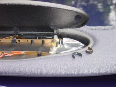

Thanks for your help with the rear window trim issue. Is it possible to remove the sun visor mirror assembly from the visor. Both return springs shown in the foreground of the photo have come loose and were bouncing around inside the mirror. At least I have found yet another annoying rattle but the mirror wont stay open and moves when the visor is down.

Well, the springs are just little brass clips (as Glenn showed in the first pic). So the problem is likely finding just those pieces or making your own.

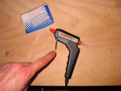

As I said you'll need one of these:
I've added the picture because I suppose it's not really called a hot glue pistol in english.

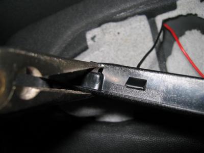

Okay, then use some small pliers to press the brass clip in place. Most likely the plastic piece will now fail completely and you will find yourself searching for the clip. A light interior color will help :)

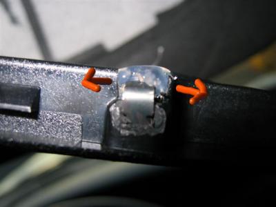

Meanwhile you should have heated the glue pistol and now use it to fix the clip in its position. I did this alone and with the visor still attached to the car, so if you can find a second person to hold the pliers while you do this you'll be less frustrated. Make sure to apply the glue generously and since it doesn't really deserve the name 'glue' but is rather liquid plastic you have to assure a mechanical hold. THIS IS REALLY IMPORTANT.Do this by squeezing it sideways under the plastic (arrows). Don't worry, nobody will see the mess after reassembling it. Now you need to wait about one minute for it to get hard. (The glue!) You might have to extend the waiting since I had close to freezing point inside the car that day :eek:
