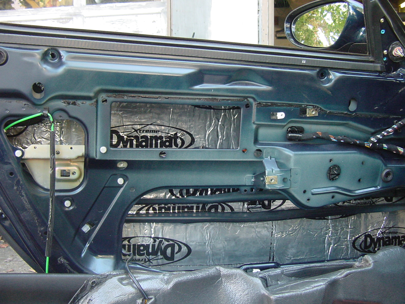

Mark:
Here is a photo of a Boxster door, after removal of the interior trim. Note that some soundproofing has been added, otherwise it's very similar to the 996:
Also, I found that if you just remove the foam liner on three of the four sides (top, left and right), you won't spend any time lining it up again, and it will be perfectly fitted exactly where it originally was.
Regards, Maurice.

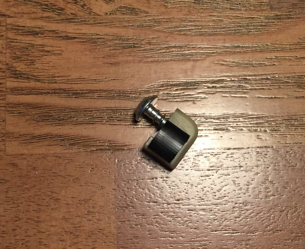

- The OEM part has two bumpers on the bottom of the right side rail.  (pic attached.)  Apparently both bumpers are needed if you have a Boxster.  If you have a 911, you need to remove the top bumper, otherwise, the window will not go all the way down.  Just loosen the torx screw and it comes right off.  I didn't realize this until after I put the whole thing back together.  Hope this saves someone else from having to remove the door panel twice.
