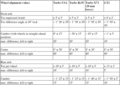

  10. From the Service Manual (alignment specs). If your paper from the dealer does meet these - then they are wrong. Danger of injury and damage to property due to malfunctions in the PSM control range if the steering angle sensor is not calibrated or is calibrated incorrectly! - Calibrate steering angle sensor with wheels in straight−ahead position with the Porsche System Tester 2! - The steering angle sensor actual value must be checked after a suspension alignment where no changes were made to the wheel alignment values! Note: - The following values relate to the empty weight, i.e., full fuel tank, vehicle with spare wheel/collapsible wheel (not GT2) and tools, but without driver and without additional weight. - A caster adjustment is normally not necessary and is therefore not present. - The toe-difference angle value is also influenced by the vehicle height! For this reason the measured result must be evaluated accordingly! No action is ecessary in the case of small deviations from the toe−difference angle required value, as long as the value to the right and the left is almost the same!

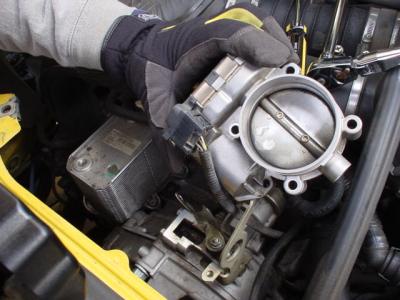

  13. :clapping: I thought so. Both the throttle body and tube should be clean and free from dirt or grease (grease attracts dirt). I usually just put both hands around it and move it back and forth until I get one (barely) side started - then push straight on.

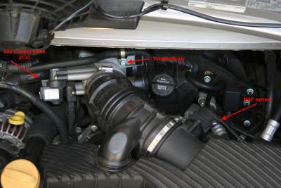

  19. It is not the MAF - the MAF does nothing at idle. Chancers are you have a carbon buildup around the throttle butterfly. On egas cars there is no idle control valve like the older cars - instead the throttle butterfly is opened just slightly to maintain and control the idle. If you look at the pic I posted above - that is Tariq's car and he had exactly the same problem. On the outside if you look at that throttle body it does not look to bad. But if you push the throttle butterfly open you would see carbon buildup all around the butterfly seating surfaces. Once we cleaned this off his idle was rock stable. You could try some Techron in the gas but the best short term fix is to clean the throttle body with some spray card/fuel injector cleaner (keep it off the paint). You will need to push the butterfly open with your finger to clean inside. Let it dry for a few minutes then start the car. I find a bottle of Techron every 3000 miles or really helps prevent the buildup.
