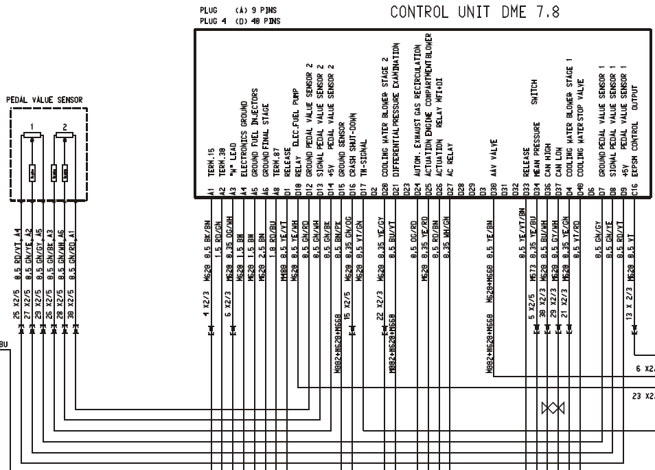

  9. Almost sounds like an intermittent wire or connection since sometimes it works. I wonder if the pedal sensor is bad? The Durametric Software can read and reset codes for ABS, PSM, AC/Heating, Airbags, Tiptronic, Seat memory, etc. It can read but not reset alarm codes. I don't know of any other tool that can do that besides a used PST2 ($2000-$4000 on eBay) or a PIWIS $18,000 at your dealer.
