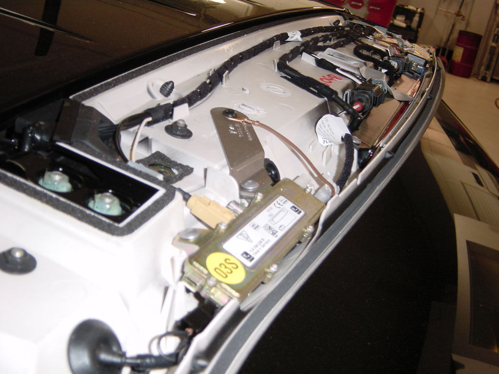

  2. I have not done this but here is what the service manual says. 1. Open rear window and pull off cover caps from the fastening screws. 2. Removing upper part of rear spoiler. Unscrew fastening screws (3 I think) from inside. 3. Remove upper part of rear spoiler backwards and upwards. Nothing in there anyway... ;)
