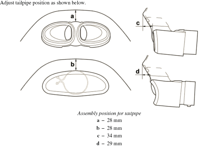

  23. Sounds like it is not properly aligned. I think your dealer needs to fix that since they did the work.
